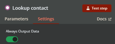

My node is configured to always output data (otherwise it would stop execution).
1/ If I run the node to lookup for an email I know exists, data is properly returned:
2/ But if I lookup an email I know does not exist and test the step, the node executes but nothing is returned despite my config!
3/ Even weirder: now when I go back to an email I know exists (same setup as 1), nothing is returned again (same output as 2). Even using query conditions that I know for a fact yield an output. Every test of the node fails without output.
4/ And, weirderer: this lasts until I refresh my browser page. Then I can go back to testing the node to query a contact I know exists.

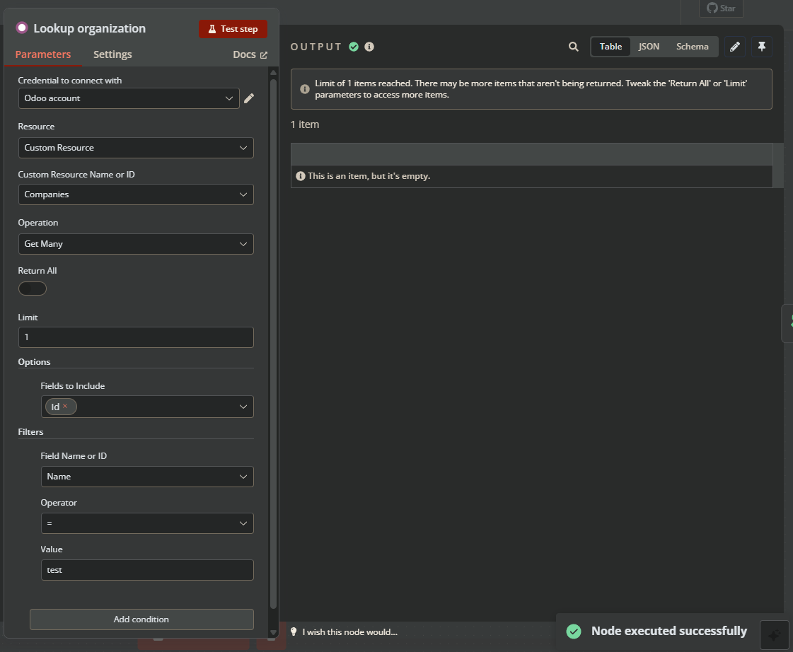

Oddly enough, the very same setup works fine for companies (targeting the Odoo table Companies):
