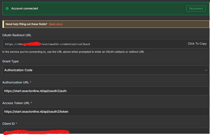

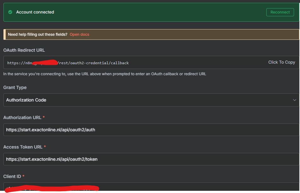

Have you added your callback URL to your exactonline app?
Yes I added it the auth workflow works fine but after a while it just gives me this error.
If I didn’t add the callback to my app it would give a error when connecting the account

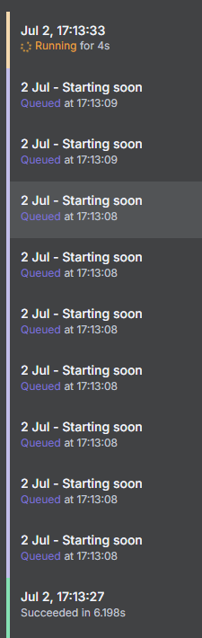

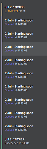

Thanks for the update. I’m trying some things as well. First I thought maybe it was a simultaneous sync on the same webhook which possibly invalidates the refresh token (in your logs the problem also happens on the same second). But today it still invalidated even though the hook was only called once.
Yes I had the same idea I’m trying now with que mode and then seeing what happens and I also added a wait node after every webhook call
I was looking at this mode as well. We will implement it in our docker setup if it fixes the problem on your end.
Im sending a simple request to Exact now every 5 minutes to see if that does anything. Maybe it can’t handle a long time between calls. Don’t expect that will fix anything. But we’ll see.

I suspect the issue is being caused by the StockPositions webhook. When a single order contains multiple products, the webhook seems to trigger for all of them simultaneously. I’m currently testing with queue mode enabled to see if that resolves the problem.
So far it is working fine but I just want to make sure before marking it as a solution.
Ah, yeah then it will be the webhooks coming in at the same time that messes it up when the refresh happens.
n8n queue mode will not help with solving that.
I would push everything to an actual queue like rabbitmq and then process them one by one from there. Can also use Redis or something else, but the RabbitMQ native nodes provide all needed functionality.
It does seem to help because it not caused by the webhook itself but by the call that is made to exact right after here. So far it seems that my problem is solved @pauljunior.
This is what my workflow looks like @BramKn (I added the wait node to add a delay in between the webhook requests)
Thanks. We are using RabbitMQ now to queue the data for Exact and the issue seems to be solved with that solution as well!
