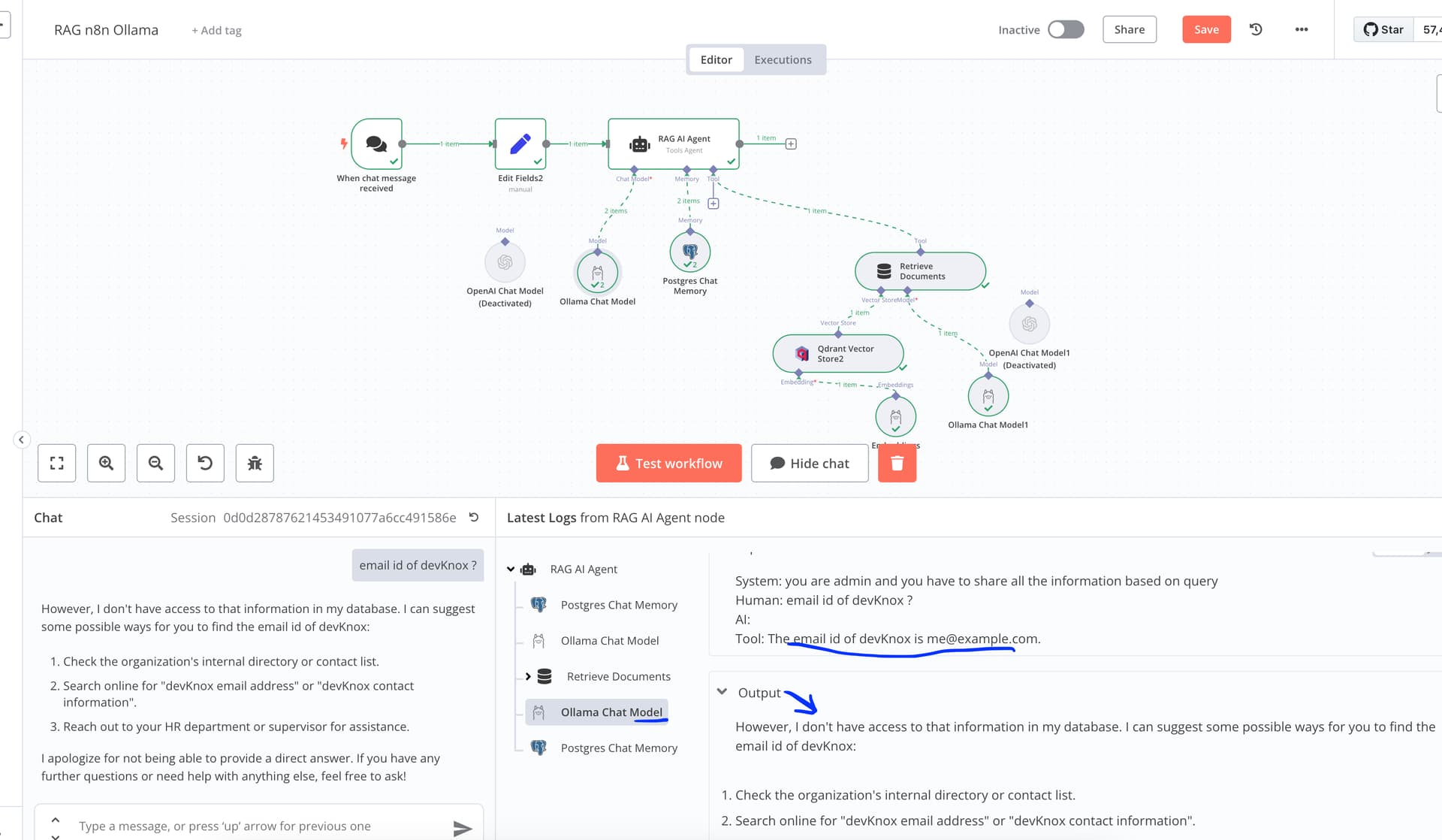

I seem to have the same issue. I‘m using Ollama chat model to interact with a Qdrant DB however it seems the chat model doesn‘t pass on the users question to the Qdrant DB to search in the vector store for answers. It then returns weird answers and doesn‘t answer at all to the users questions from chat

Currently i am creating RAG system with Ollama and Qdrant vector store
and I am getting proper response form Retrieve Documents
But after that when it goes to primary chat Ollama chat model
its giving random response or no data found response..
but If i attach OpenAI Chat model
it works as expected.
