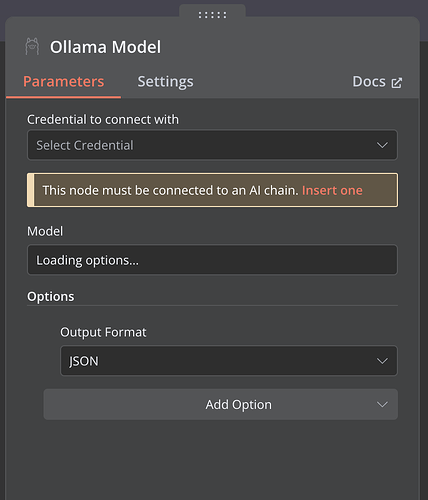

I have checked both Ollama Nodes and both have the option to return the output as JSON.

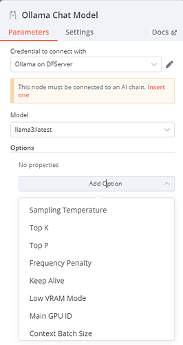

When I open an Ollama Chat Model there is no Option for JSON:
There is only an option in Basic LLM Chain where I connect it to specify an format but that is not the format-option for Ollama but so parse and repair invalid json.
What version is your screenshot from, maybe I have to downgrade?
Thank you!

Just upgraded to 1.46 to test. And it’s there…
Sorry but, did you try to scroll in the drop-down list that you’re getting? :see_no_evil: It’s at the very bottom…
:rofl: :joy: :see_no_evil:
You are right! Thank you! I was not able to see one can scroll.
So now I can proceed. Thank you very much for that hint!
