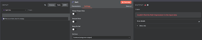

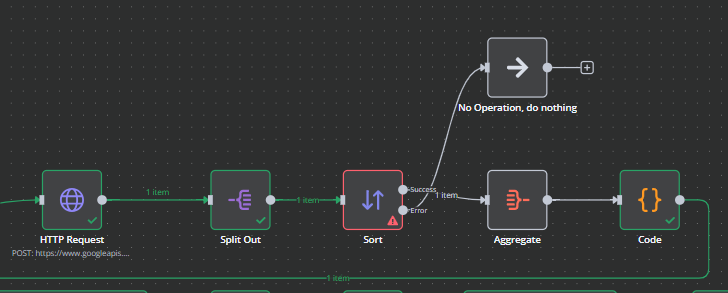

Settings “on error” set to continue using error output doesn’t work at least on Sort node.
Node just throwing an error without going to error branch.
Screen from my nodes

Unset the switch “Always Output Data” from the Split Out node or add an IF node checking that the $json
object is not empty.

If i unset AOD, workflow will stop. I have a loop there so it’s not feasible solution.
I will add IF node as manual check, thanks.
But problem is still to repair.

Maybe n8n will add that functionality to the Sort node, but it’s quite rare case to use the Sort node. As not all nodes actually support the Error branch. Better to submit a bug report via the GitHub
