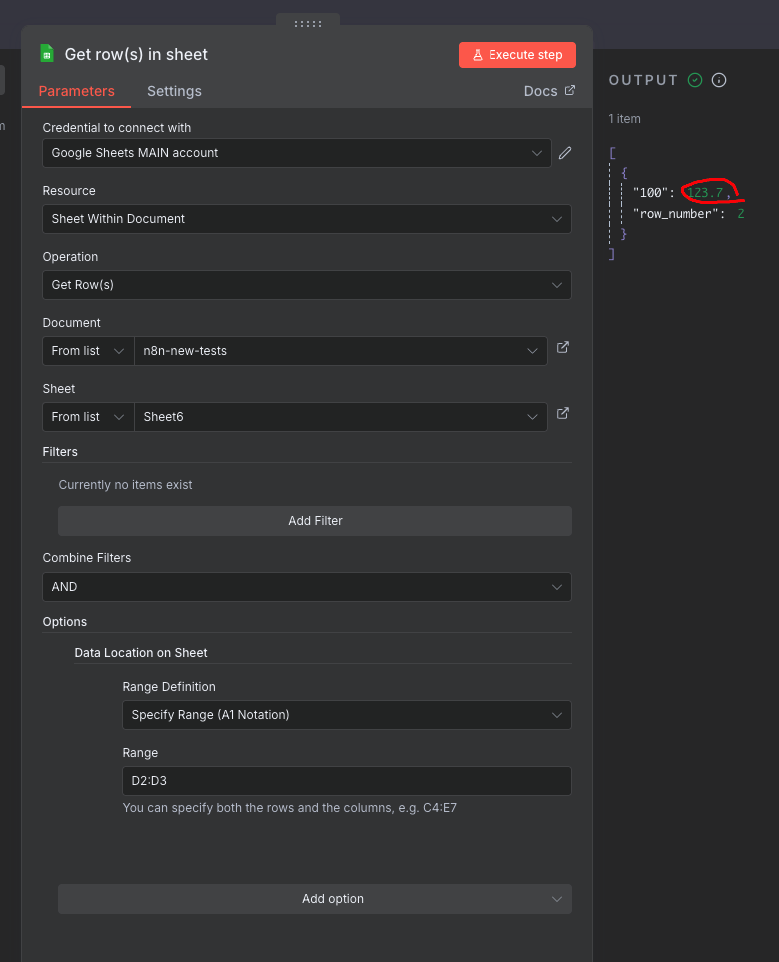

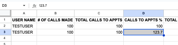

The Process Status column has a value 1

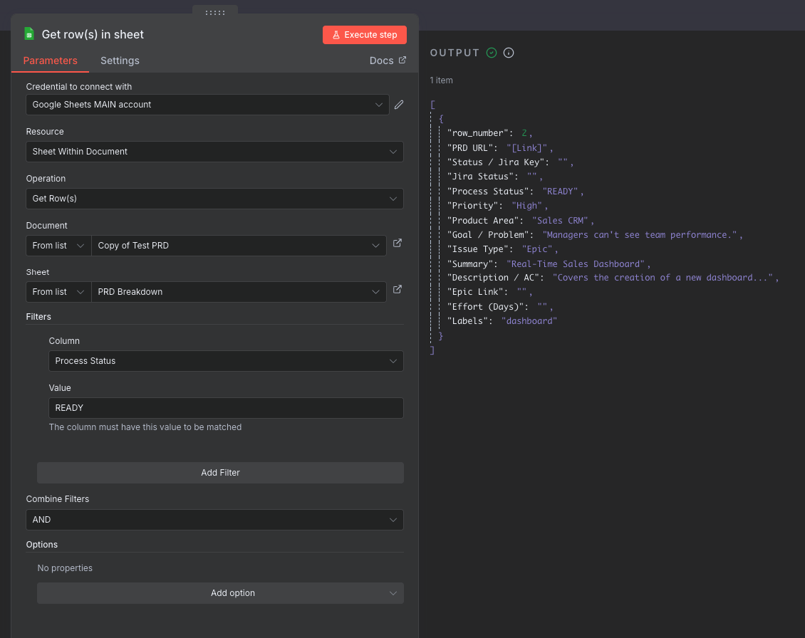

I made a copy and changed the value to READY instead of 1.
If you need to find rows with this column equal to READY, so it like this:
its working now, really appreciate for the help
