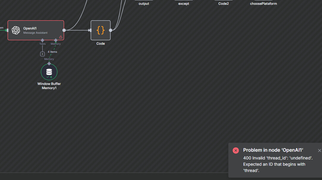

I’m using the n8n Assistant OpenAI node in a chatbot flow.
To handle conversational memory, I connected a Window Buffer Memory node (memoryBufferWindow) with a custom sessionKey based on the user’s contact info (e.g., WhatsApp number + platform ID). I then connected its ai_memory output to the Assistant node.
My expectation was that the Assistant node would use the local memory and not require any OpenAI thread_id, since I’m trying to manage conversation context entirely within n8n — not in the OpenAI cloud.

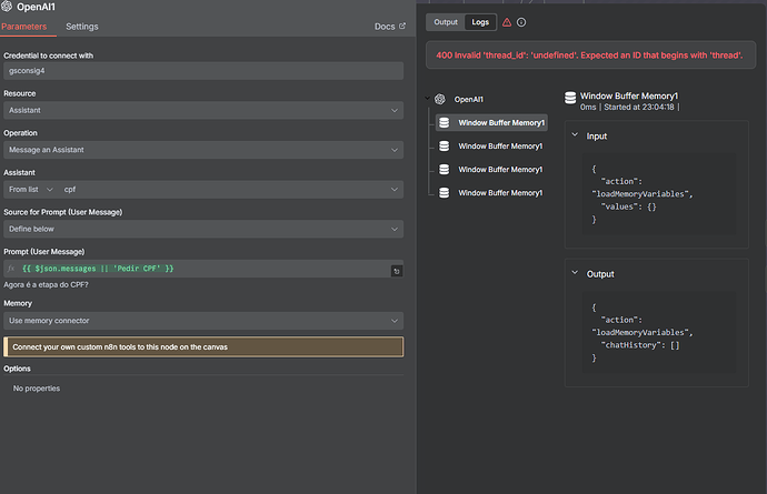

Issue:
Despite having memory connected, the Assistant node throws this error when triggered:
csharp
CopyEdit
400 Invalid 'thread_id': 'undefined'. Expected an ID that begins with 'thread'.
This seems to indicate that the node requires a valid thread_id no matter what, even when memory is already being handled via the built-in buffer.

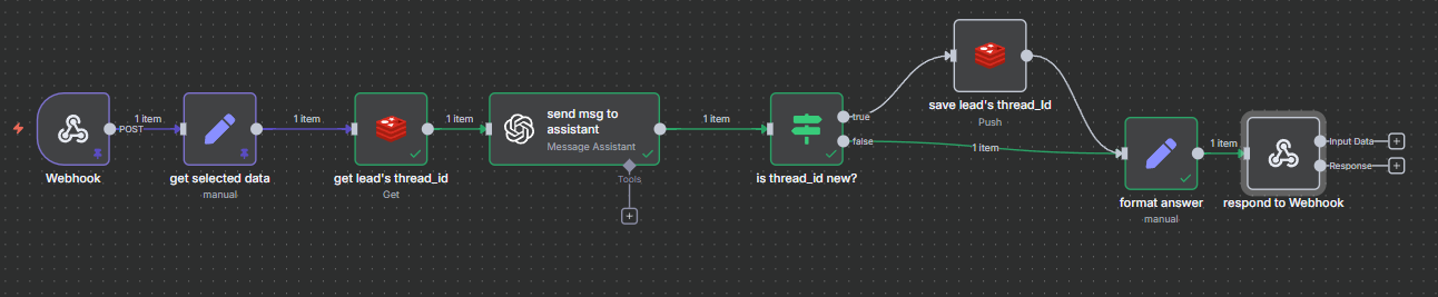

This is the fastest way I found to solve the problem:
Using Redis as thread memory, I did the following.
If “get thread_id” (for instance, using lead’s phone number) returns null, the assistant creates one. The checkpoint after assistant decides if thread_id is new (checking the answer of “get thread_id”) to store it, if necessary.
If you have any doubt, just let me know.
