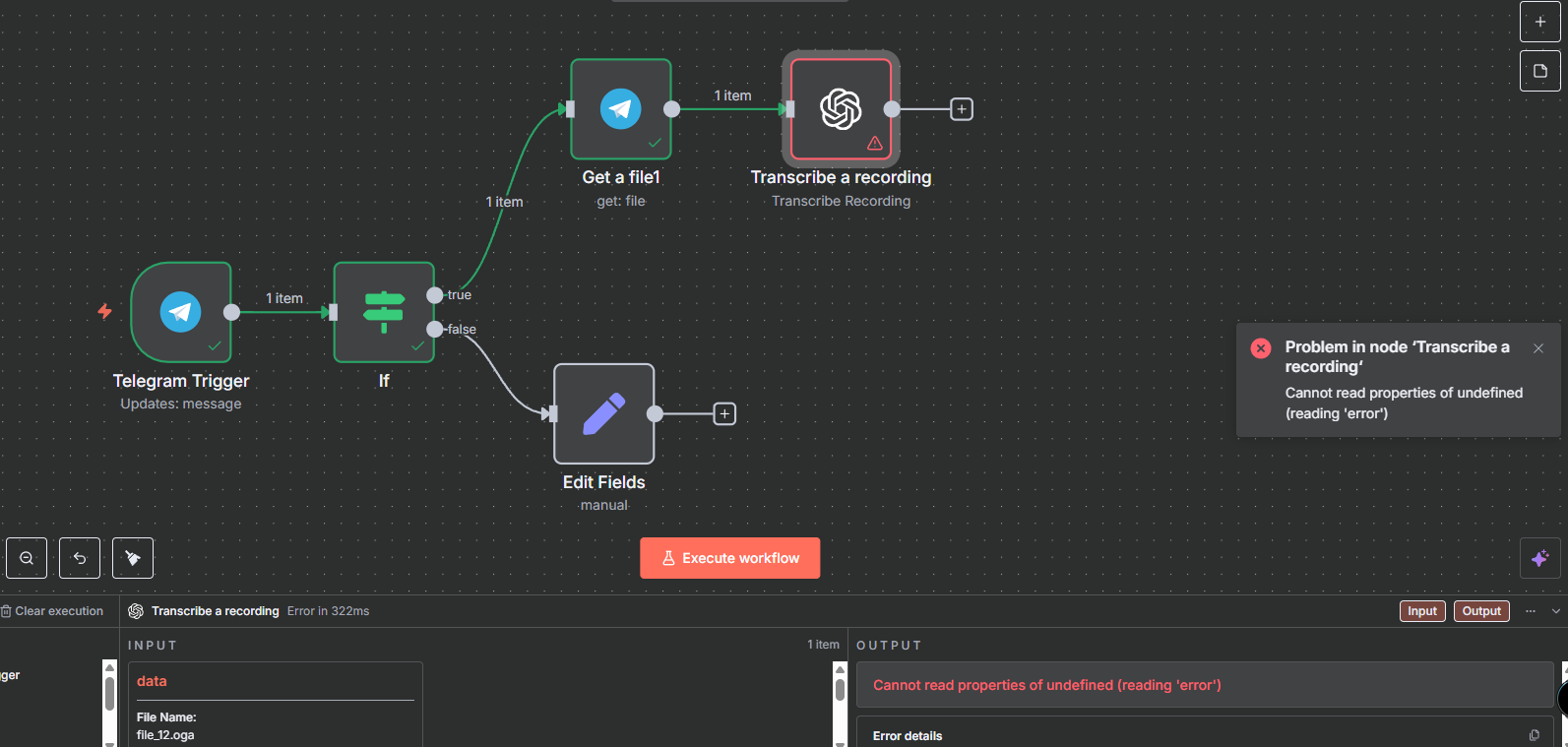

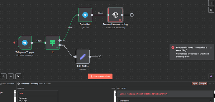

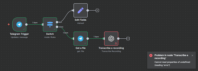

I have sent the audio message via Telegram, and I got the message shown in the image.
WHY???

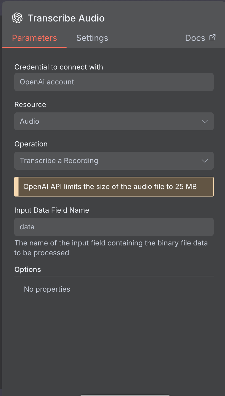

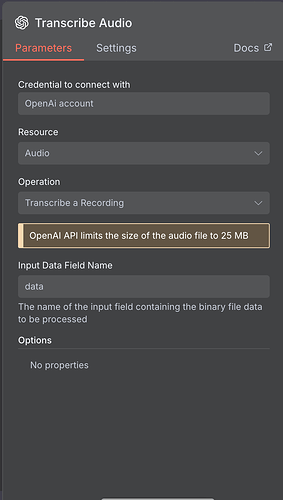

Try to config Transcribe a recording as below

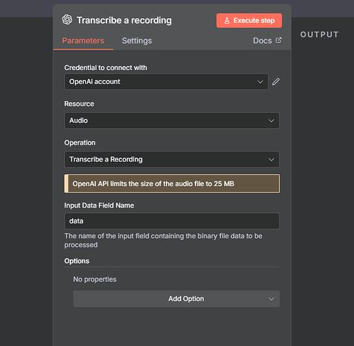

Here is mine!
I coppied your flow, and its worked for me
But you can try this one instead

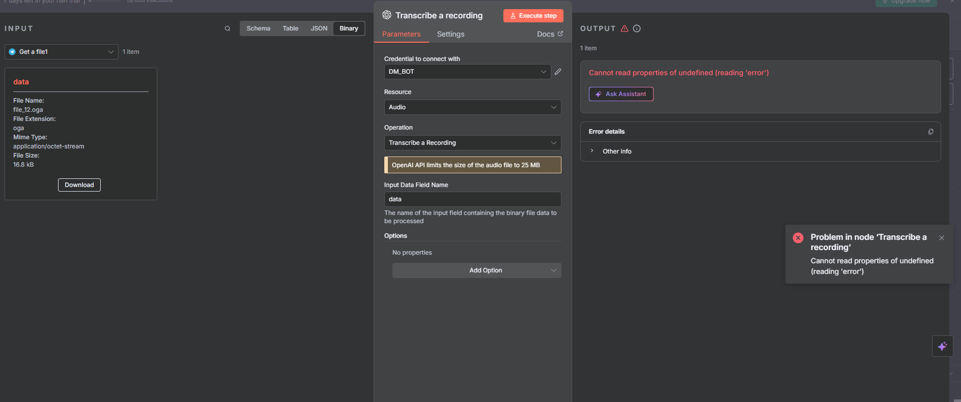

I got the same error, WHY?
Why works with you and not with me.
Do you think if i upgrade my plan in open AI will fix the issue.
Did you configure your OpenAI API key already?
I got the solution, I was in a free plan in the open AI platform.
Once I charged my account with a credit, I got it work perfectly.
Thank you so much guys
Glad to hear you’ve identified the root cause! If my suggestion helped resolve the issue, I’d appreciate it if you could mark it as the solution. Thanks!

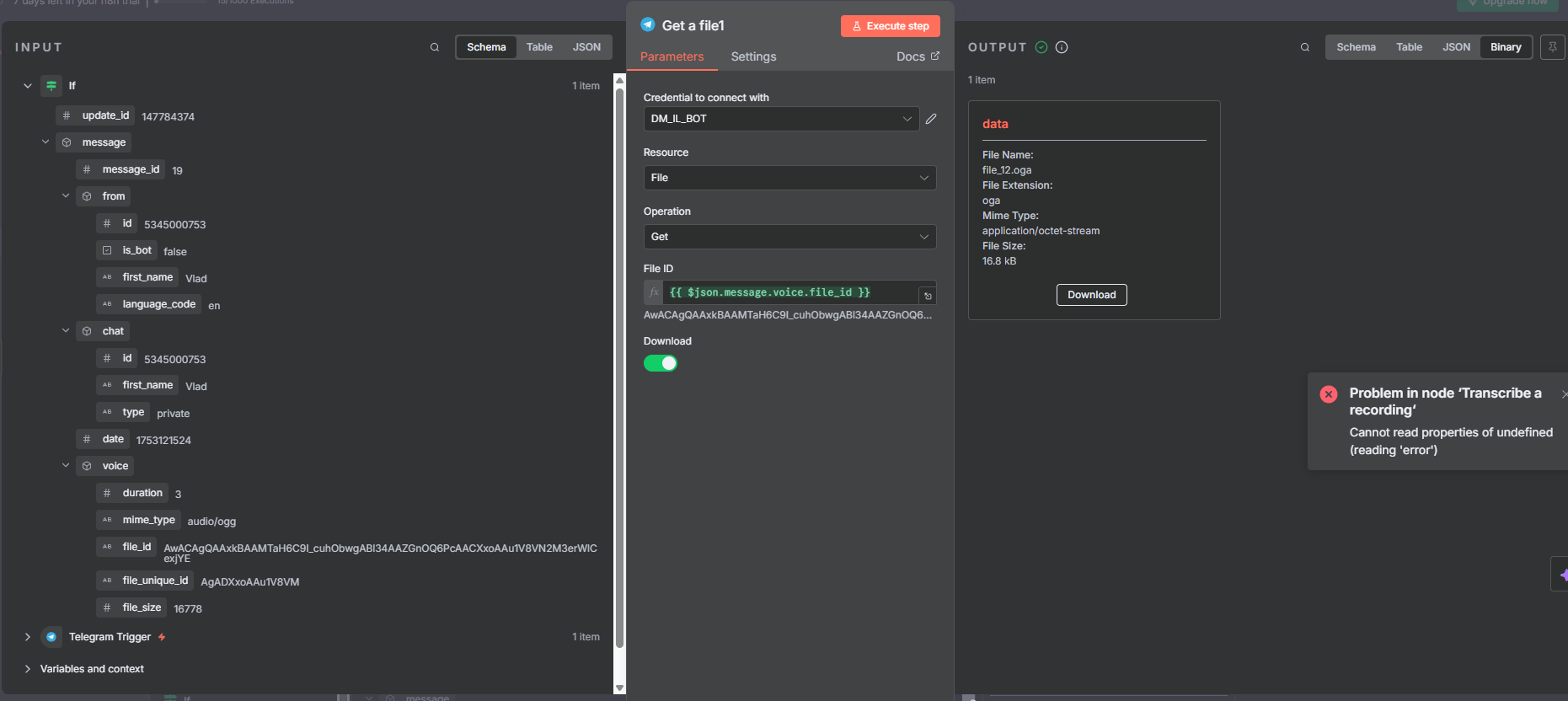

Hi guys, i have the same issue and losing my mind over it, I tried to follow a guide on youtube and i did every step that he had but it doesn’t work, can someone help me?
cann’t understand why, here is my workflow
Hi, I think you’re currently on a free plan with OpenAI. You should charge it to my account using a credit — that should work.

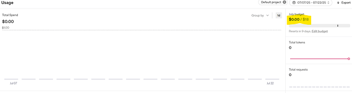

I created API key while using my ChatGPT plus account and it looks like i have some credits to use.
what am i missing?
well i add more credits and it works now.
