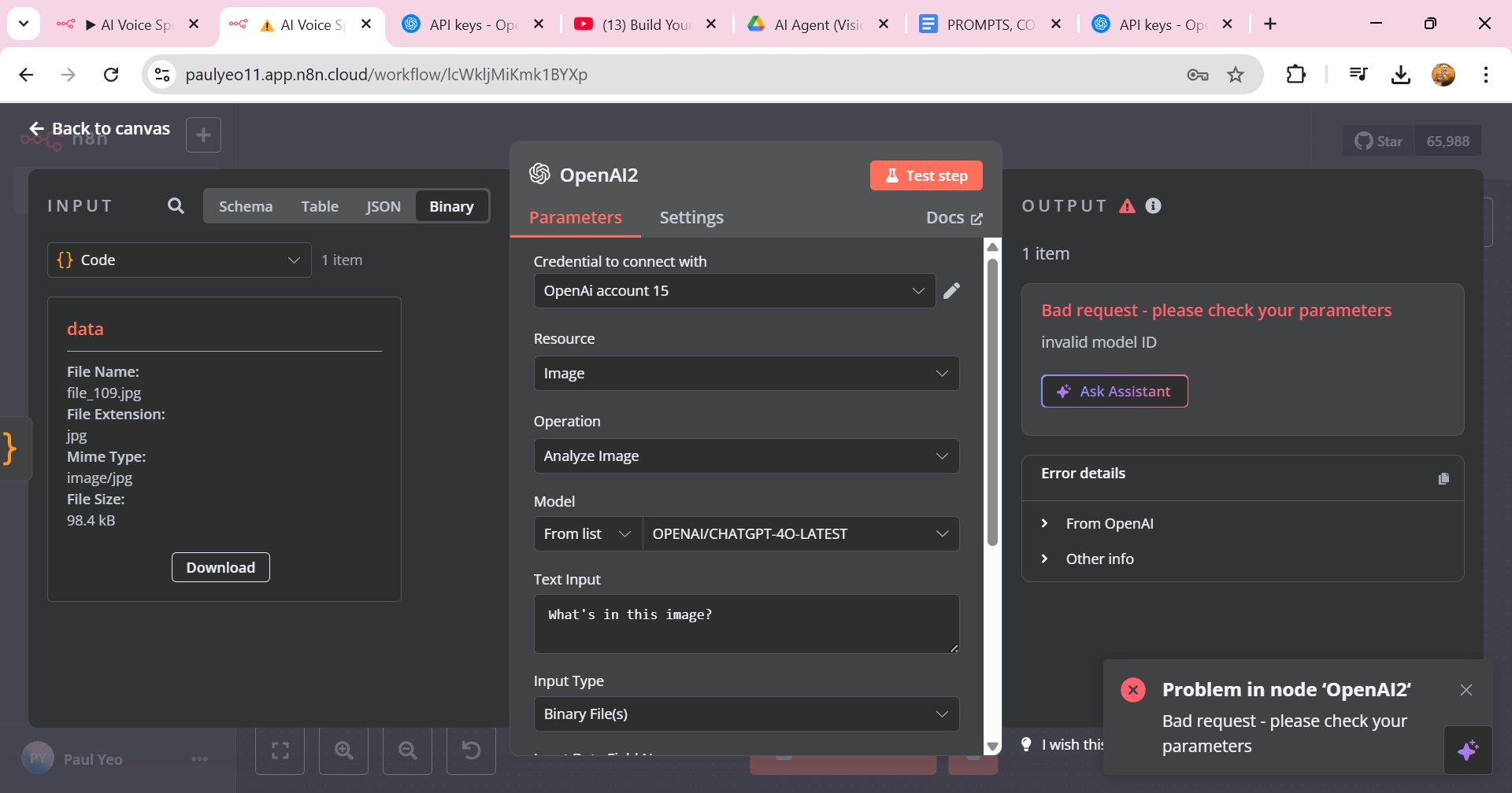

I am try to learn how to create AI Agent can see , by follow below you tube :-
I encounter issue , When I try to analyze the image , I use OpenAI , Analyze image module.
I get error code :- Problem in node “OpenAIZ’” , Bad request - pls check your parameters.
Enclose screen shot are my error msg and error code.
Video show my program :-
Hope some one can help me.
Remark :- I have credential set up for all module.
Paul
Not all models support analyzing images I believe. Maybe that’s why you get invalid model.
Thank you very much for your reply . I follow the you tuber video step by step , his working mine is not working . Must be some where I set wrongly ?
Try using GPT-40-MINI, works for me.
Hi Hans , it wiork fine now . Many thank.
No thanks, happy to see it works!
