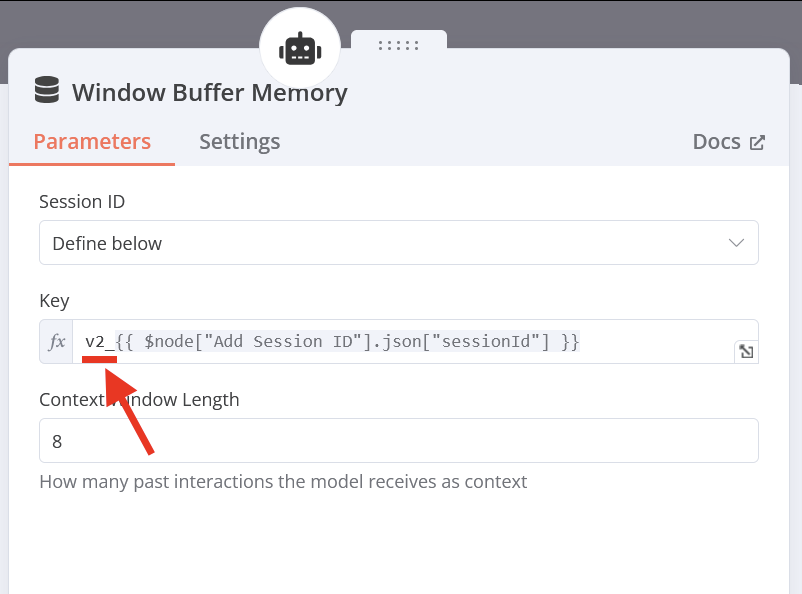

I had this same issue and fixed it. I’m not sure if this fix will work for everyone, but I thought I’d share.

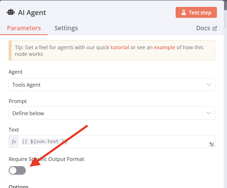

What I noticed was that the JSON coming from my agent had an additional key in it called “blocks”. I had been experimenting with trying to get my agent to output Slack Block Kit formatted JSON, but eventually decided to scrap that idea. However, I think that since that concept of blocks was already in the agent’s window memory, it kept resurfacing.
And something about that extra key caused problems later when I turned off ‘Require Specific Output Format’ in my AI Agent
Here’s how I solved it:
  1. I removed the Window Buffer Memory node
  2. I added a new Window Buffer Memory node
  3. I changed the session key by prepending a v2_ string to it:
Steps #1 and #2 may not have been necessary, but they made me feel good.
Just to reiterate, I changed my key from
{{ $node["Add Session ID"].json["sessionId"] }}
to
v2_{{ $node["Add Session ID"].json["sessionId"] }}
This essentially wiped out the agent’s memory, and that solved my problem.
I hope that someone more educated can swoop in and add some context here. I’ve only been working with n8n for… 3 days!! Good luck!

Thank you! I had a similar issue, using Postgres memory, updated the key and it went away :grin: for a more permanent solution, I added an edit Field on the incoming message and generate an ID with the expression {{(+new Date).toString(36).slice(-5) + Math.random().toString(36).substr(2, 5)}} which I reference. Has worked like a charm
Clearing the memory / updating the key to the attached memory, seemed to do the trick here.
