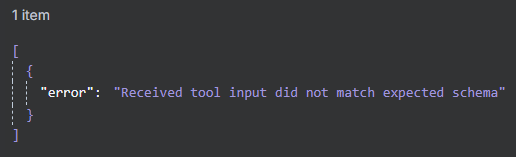

Since yesterday I have problems with the OpenAI models in my AI Tools Agent node. On Sunday it worked and I didn’t change anything.
Almost every workflow ends with a “Received tool input did not match expected schema”.
In the logs I can see that the AI wrote a response, but after that the output is this error:
If I switch to Claude 3.7 Sonnet everything works again, actually it works better than GPT-4o or GPT-4o-mini, but of course it costs much more, so I would switch back to an OpenAI model. I also tried with the new GPT-4.1 today, but the result is the same error.
Do other users have the same problem? What could be the reason for that if I didn’t change anything?
