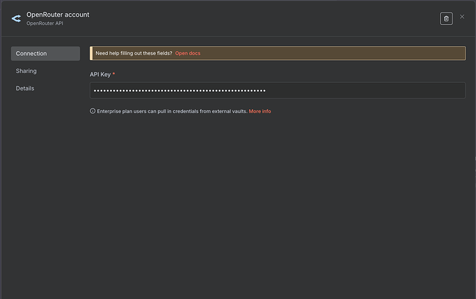

I’m using the correct node 100 %. I haven’t changed this.
The credential type is OpenRouter API you can see it here as well and from the node json I’ve provided in the workflow:
In LmChatOpenRouter.node.js - supplyData I have added the following:
if (!configuration.baseURL) {
    configuration.baseURL = "https://openrouter.ai/api/v1"
and now it works. But this should not be needed. There is some bug in n8n code on how it handles the credentials at least for OpenRouter model node.
