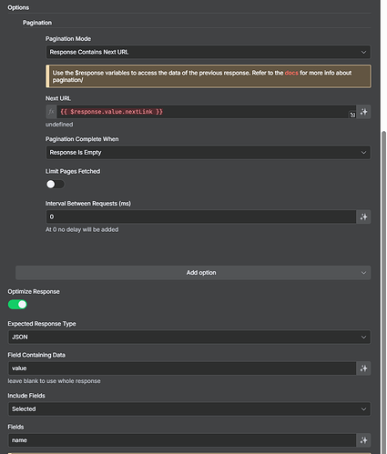

Searched for a solution in community forum, tried multiple values / expressions but not getting the desired output response with “HTTP Request Tool”.

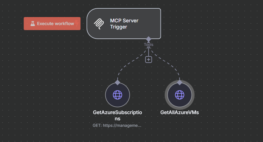

I developed an MCP Server Trigger for Azure data retrieval. The implementation uses a Graph API endpoint to fetch all VM instances (https://management.azure.com/subscriptions/[subscription-id]/providers/Microsoft.Compute/virtualMachines?api-version=2023-03-01)
The response is too large for my Azure AI agent, so I want to use the “Optimize Response” option.
Below example response:
“response”: [
“value”: [
“name”: “APP001”,
“id”: “/subscriptions/ZZZZ”,
“type”: “Microsoft.Compute/virtualMachines”,
“location”: “westeurope”,
“tags”: {
“displayName”: “VM”
“name”: “APP002”,
“id”: “/subscriptions/ZZZZZ”,
“tags”: {
“displayName”: “VM”
“nextLink”: “https://management.azure.com/subscriptions/…”
I need two things from the response: the Name of each VM and the nextLink to retrieve additional VMs.

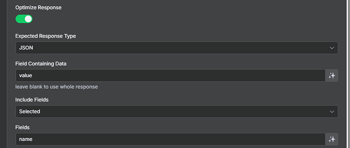

Things I tried:
Test 1
Output: Response shows the VM names but missing the nextLink
Test 2
Output: Response shows nextLink but missing VM names
Troubleshooting: value[0].name retrieves single VM only; map() expression unsuccessful
Test 3
Output: The MCP Server Trigger - GetAllAzureVMs is timing out. I’m uncertain if my implementation is correct.
See explantion above in output.

Not sure if this helps, but a workaround for me was to generate an arbitrary number of fields automatically. Downside is you’ll get alot of nulls, but assuming you set your upper bound to a higher enough number you can catch everything, and let the LLM exclude the nulls…
  • Include Fields: Selected
  • Fields [Expression]:
{{ […Array(5).keys()].map( m => ‘value[' +m+ '].name').join() }}
