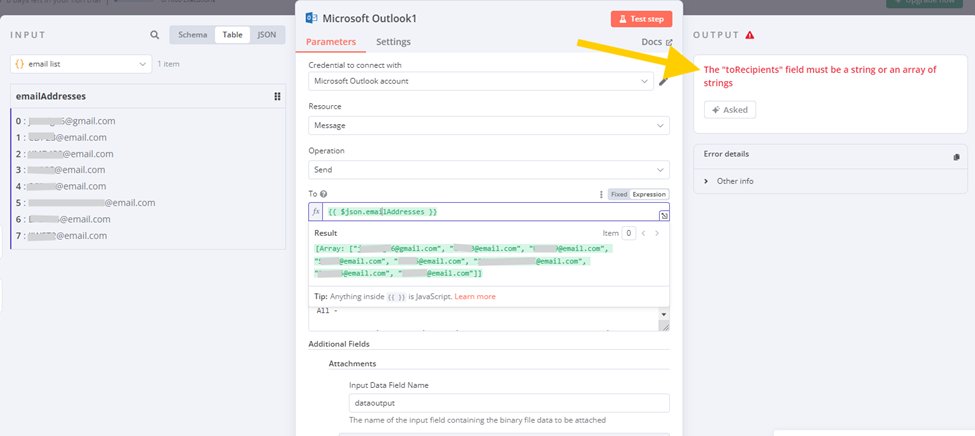

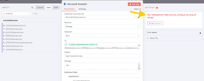

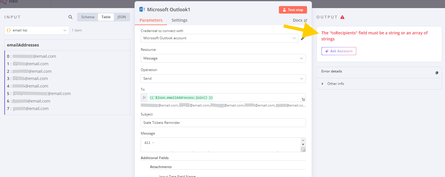

Steps 1 through 6 are working great. I run into a problem when trying to populate the TO field in the Outlook node. No matter how I format things, I keep getting an error related to string or an array.
I tried modifying my code in the email node to change the output:

I have tried returning the emailString, the emailAddresses, and the emailArray. All give me the same error.
If I simply put a fixed email in the TO field – it works.
Suggestions?

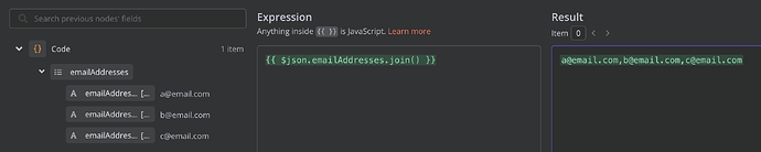

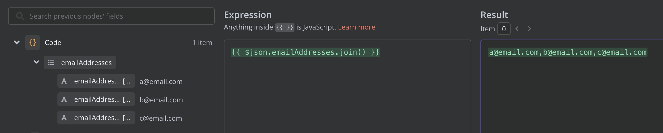

Hey @Jamie_C , you do not need such a complex code to produce a list of comma separated email addresses. Try this expression instead
{{ $json.emailAddresses.join() }}

I have tried simply using the expression you gave as the expression in the Outlook node’s To: field. I did this by commenting out the const emailString and const emailArray lines in the code and returned only emailAddresses. Then, I used the expression in the To field. I get the list of email like you showed, but still get the error.

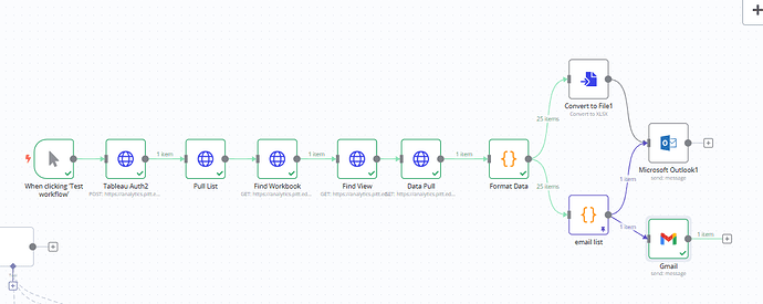

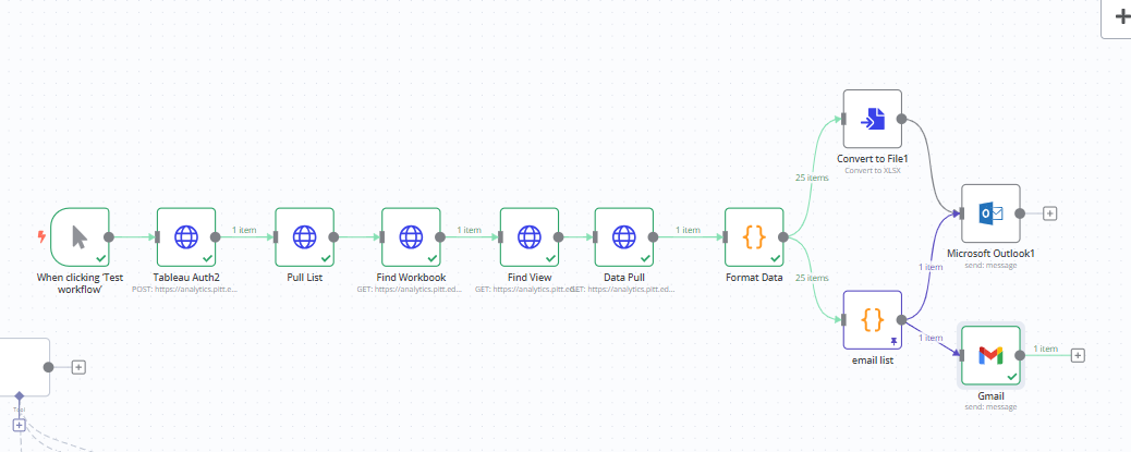

I am starting to think there is a bug in the Outlook node.
I added a Gmail node and connected to my Gmail account.
This is pulling the same email list that is NOT working in the Outlook node. It does work in the Gmail node.
Help?

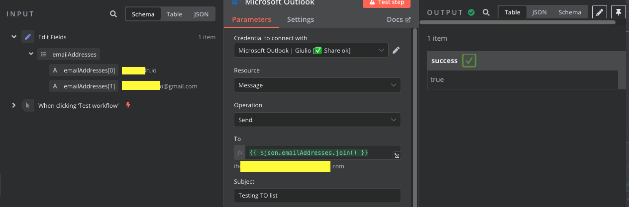

Hey @Jamie_C , works for me on 1.62.1

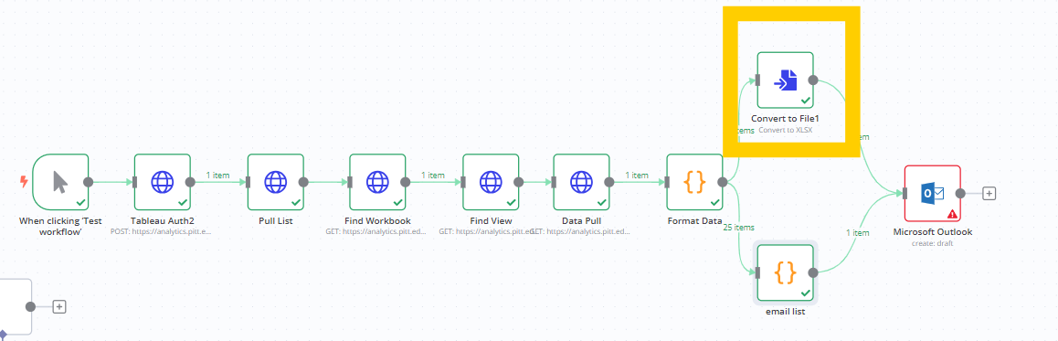

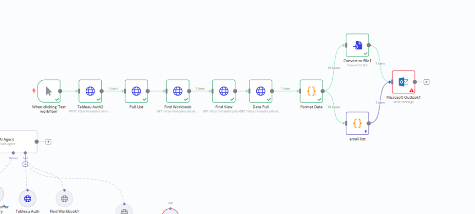

Thanks! That gave me an idea. I should eliminate other variables. In my original flow, I was also pulling in a file as an attachment. If I remove that node from the flow - at least the connection to the outlook node - I can create the email.
As soon as I make that connection, it starts failing with that same error. I do not even have to add an attachment. It is just that connection to the node.
Based on the options in the Outlook node, I think I should be able to attach a file directly from the Convert to file node. Is that correct or am I missing a step?

Hey @Jamie_C , do you intent to attach the file and send it out to the email addresses in the same email? Than your workflow cannot fulfill that as you are separating the file from the email list. This way you are attempting to send the email twice: one with attachment without the email address (hence the error you are getting) and the other email without the attachment (never happens as it fails the first time when attempting to send attachments).
For it to work, one of the option is for you to merge the two nodes first just before the Outlook node. Something like this.
Thank you! You are awesome! Also, you are correct. I want to attach the file to the email and send the email out to the list.

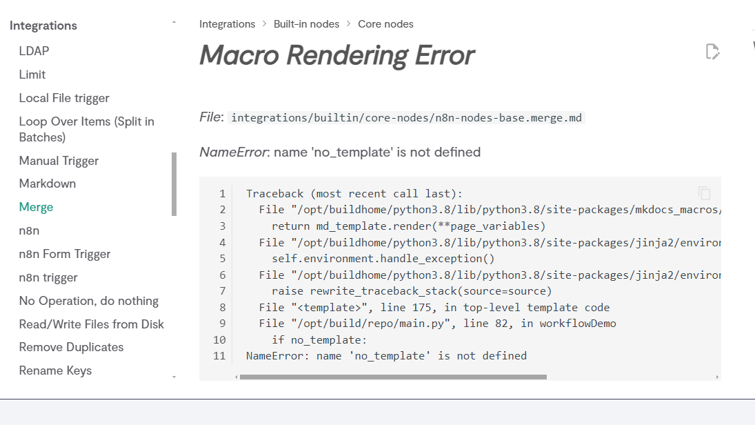

Is there any documentation on how to setup the Merge node?
I am not sure whether to use Append, Combine, Choose a branch?
I tried looking in the documentation section but this appears:
Thanks again! One step closer.
Hey @Jamie_C , the way I showed in the workflow is the way to go provided both “Convert to File” and “email list” produce only one item. That is pick the the mode “Combine” and combine by “Position”. This will allow creating only 1 items with properties from both nodes.
There seems to be an issue with the page indeed. We would have to fix that. Thanks for pointing out to it.
Thank you! That worked!!!
