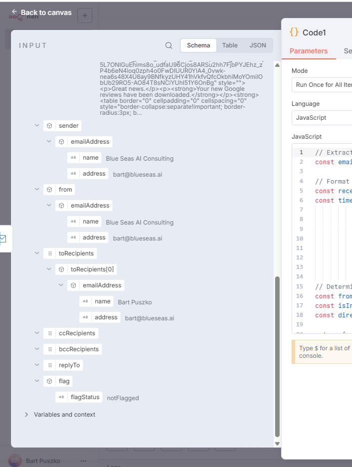

For context, here is a screenshot of the output for a standard email I’m currently working with, where the sender and from fields are identical. I need to know what this looks like when it’s a “sent on behalf of” email.

As far as i recall from a similar project i did earlier, the sender and from objects would be different in the case of a delegated message. So if the two are not identical, then the “sender” has sent it on behalf of “from”.
Hence, if you only want to know the origin, you should be able to just use the “from” object and ignore the “sender”.
If you want to detect the two cases, you can perhaps do a simple if from == sender then direct, else delegated.
