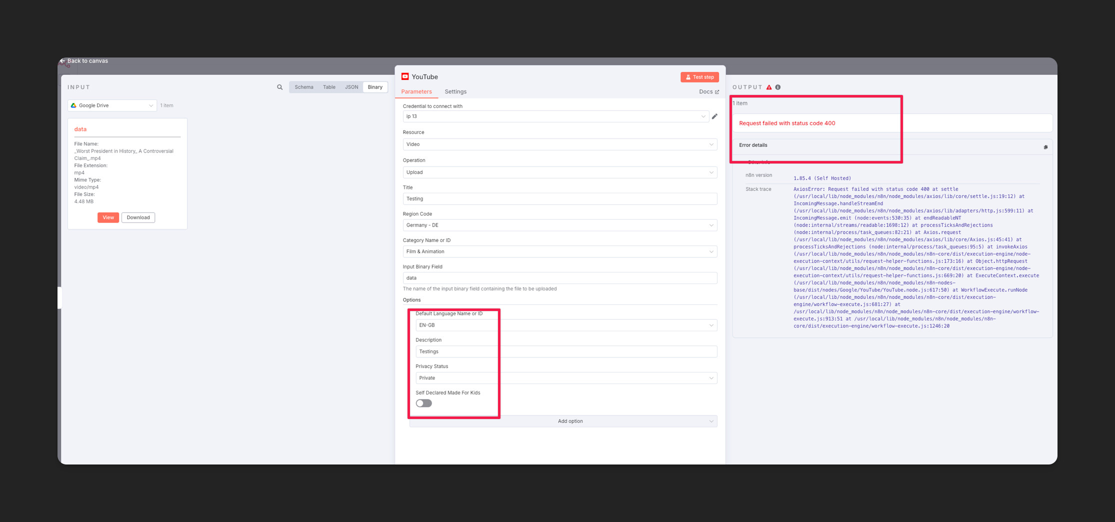

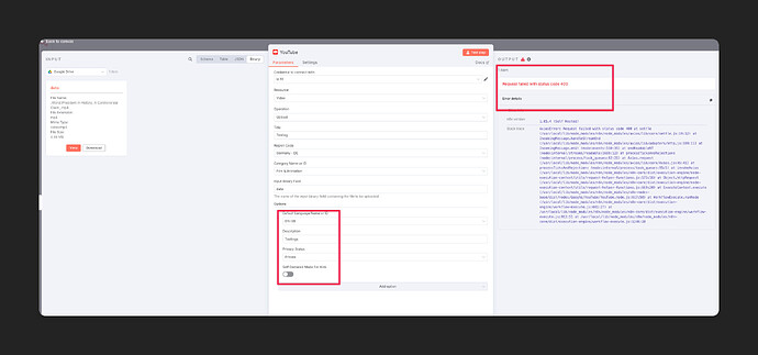

Hello n8n community,
I’m encountering a persistent 400 Bad Request error when trying to upload videos to YouTube using the YouTube Node in n8n (v1.85.4, self-hosted). Here’s what I’ve tried so far:
Error Details:
json
Copy
{ “errorMessage”: “Request failed with status code 400”, “errorDetails”: {}, “n8nDetails”: { “n8nVersion”: “1.85.4 (Self Hosted)”, “binaryDataMode”: “default”, “stackTrace”: […] } }

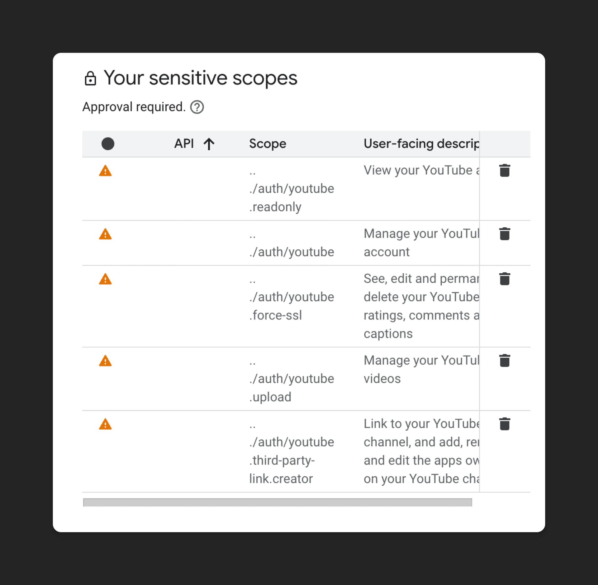

Double checked if all scopes are granted, noticed that they not approved yet. I guess that is the issues.
Waiting google to verify

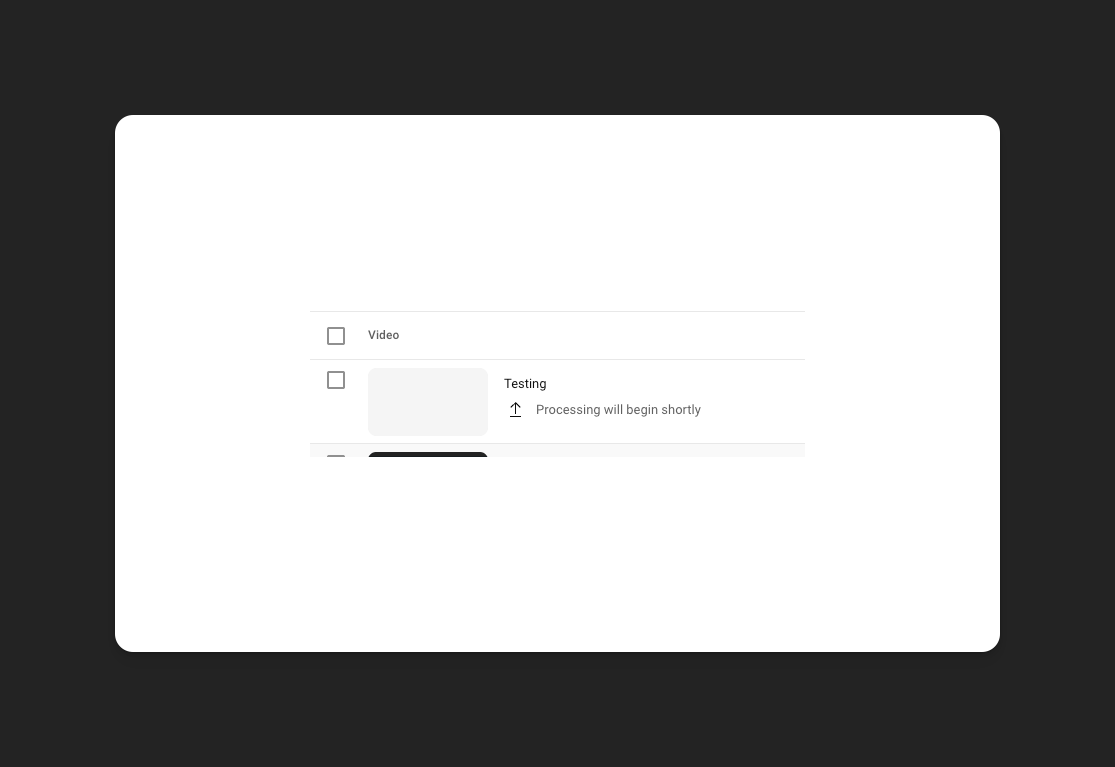

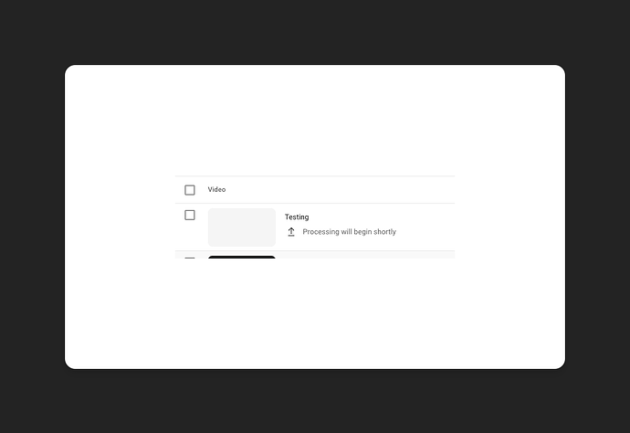

Interesting thing. I tried the same workflow on n8n cloud and everything worked.
But not on self hosted.
In both instances did use the same Google credentials. Can someone suggest how to find the source of problem?
In coolify n8n logs i can not find the problem. Error 200 in Youtube documents doesn’t really provide much context of cause.

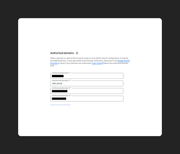

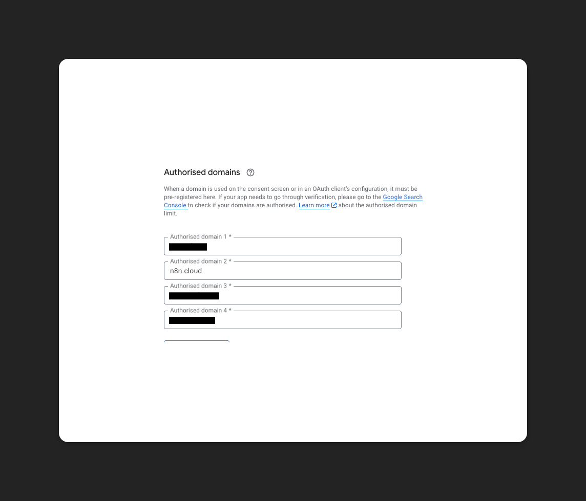

Can’t it be because of the fact in google auth you need to set an source domain/website, beside a callback URL? maybe it checks something there when making actual calls.
I have added already idomain to Authorised domains. Right now I try to figure out how to enable more detailed n8n container logs, so I could understand more of the 400 issue.
So the non-working one, is also listed in these authorized domains? since you are showing only the working one. It could be even as silly as a non-synchronized clock I guess. many possibilities
yes it is listed
