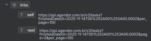

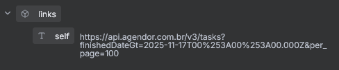

The Agendor API sent me the next page link, and when there is no next page this link doesn’t exist (as you can see in the images).

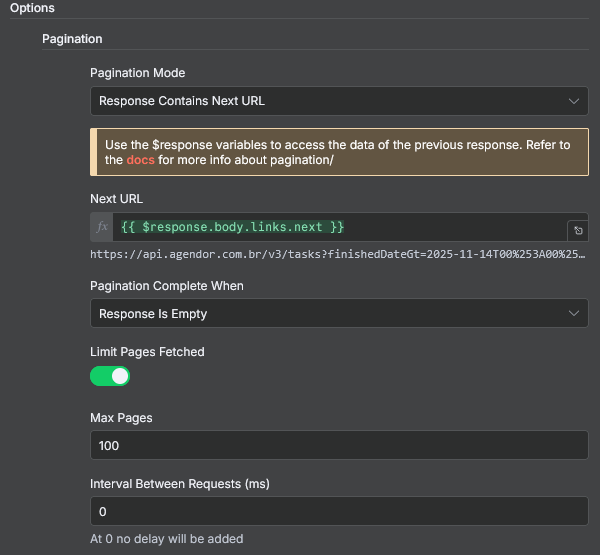

I set up Pagination mode as ‘Response Contains Next URL’ and pagination complete when ‘Response is empty’.
When I execute this node it doesn’t stop, so I set Max Pages to a 100 and when checked the data it seems to loop until it completed a 100 pages.
What I’m missing?

But I can explain why the your setting not working.
Because your Response Is Not Empty when the next page coming.
It still show the response but not having the field $response.body.links.next

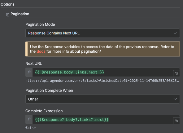

So the Pagination Complete When $response.body.links.next is not set.
Thank you very much for your response!
I will leave the complete setup, so if a newbie in n8n and javascript has the same problem, can view the solution:
the expression !$response?.body?.links?.next returns true when there is no next link.
