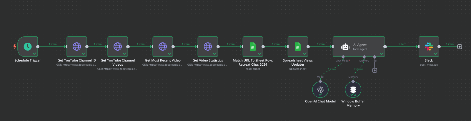

I have a workflow which is doing what I want it to (update a spreadsheet and send a Slack message).
However, the spreadsheet I have has multiple tabs (i.e. “sheets”) within it, and at times I will need data taken/added to different tabs in that sheet.
The Google sheet reader node and update node can only select one sheet within a Google spreadsheet document at a time.
How can I have my workflow parse through each sheet for the needed info?

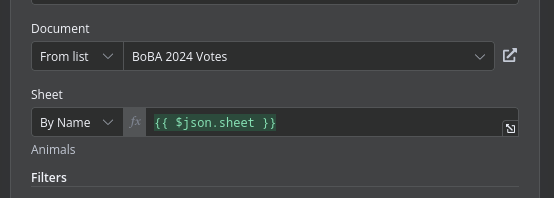

You can pass the name of the sheet as an expression. Now just build a loop around it :slight_smile:

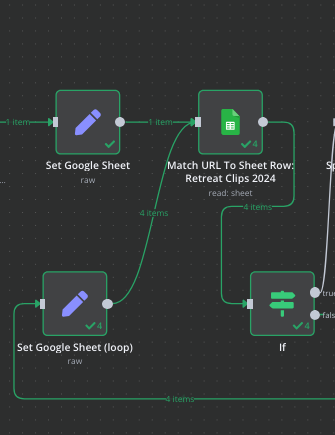

Here is my updated workflow loop:
I have to parse three sheets. This starts by sending in info about the first sheet to the Google Sheets node. If it doesn’t match, the loop sets the second sheet as the input for the Google Sheets node. If it doesn’t match… well, it just goes back into the loop, and keeps trying to set the input as the second sheet.
I need to be able to try a third sheet if both the first sheet input and the second sheet input fail. What am I missing?
