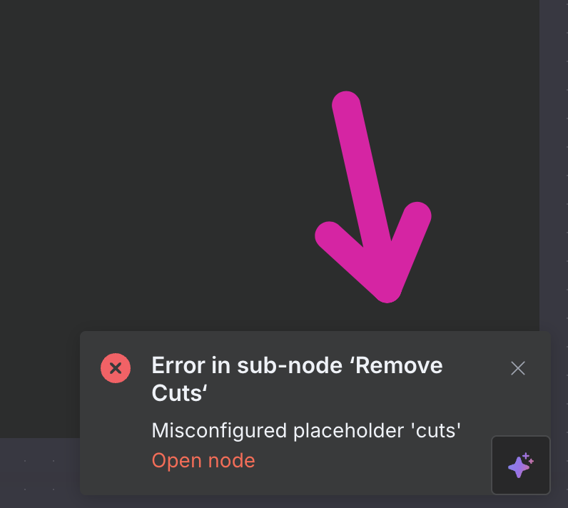

I’ve been struggling to pass anything to a MCP server that isn’t anything but a simple string (which is then passed to the tool in the server) as a {placeholder}.
When I pass a string it works fine, but part of the api tool payload is an array of objects, and I can’t seem to figure out how to properly map it in the tool. The input to the tool looks correct actually, perfect, but the server rejects it.
here is a sample of the API json for the MCP Server HTTP Tool
“video_url”: “https://sgp-labs.nyc3.digitaloceanspaces.com/file.mp4”,
“cuts”: [
“start”: “00:00:01”,
“end”: “00:00:02”
“start”: “00:00:03”,
“end”: “00:00:05”
You can see the query input is actually perfect, but I can’t see how I’m suppose to configure the backend. The server doesn’t have an “array” type.

This isn’t quite right though – there is no “previous node” as this is a MCP Server, the requests are coming from a Agent Tool.
the {video_url} isn’t really the problem, that part is working.
It’s the cuts, which are a {placeholder} coming from the client, not exactlly like the previous nodes {{ $json }}
The placeholders are defined in the server and are referenced with { }
The server is getting the currect data in string format, I can see it, but its not being properly mapped into the server {cuts} placeholder. In my previous screenshot you can see all the data.
