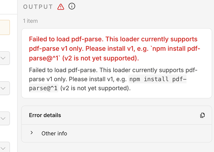

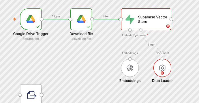

I am also facing the same issue on n8n version 2.21.7.
The Document Loader fails with:
Failed to load pdf-parse. This loader currently supports pdf-parse v1 only.
I tested with a normal text PDF (~2.4 MB) and confirmed the Google Drive download node is returning valid binary data.
