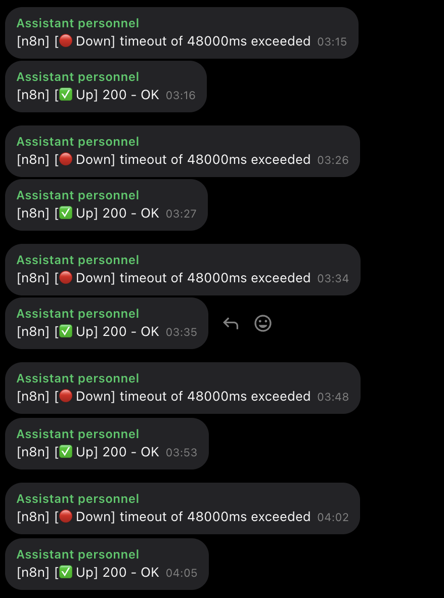

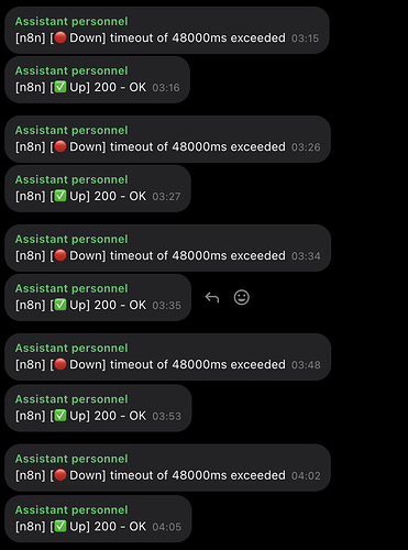

Hi @Jon , in both : production run and UI testing. In production mode multiple timeout occur, like in UI mode. I give you a screenshot of my Telegram account that recieves messages from uptime kuma.

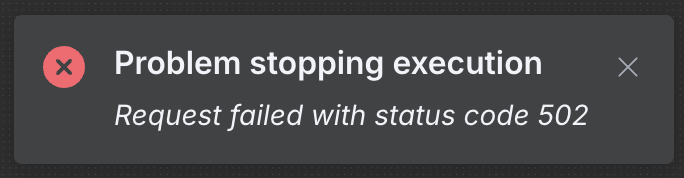

A precision : if you are in the UI and when you click to stop the workflow, it freezes everything. You have to close n8n, and when you relauch n8n, the workflow did not stop

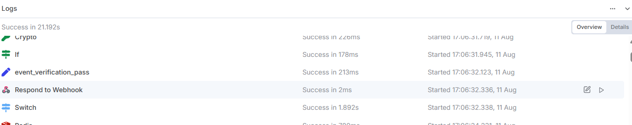

I encountered the same issue. Image 1 shows the time spent running the switch node in version 1.105.2, while image 2 shows the time spent after rolling back to version 1.104.2. Clearly, the older version takes less time.
