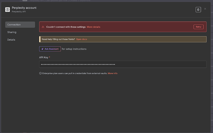

I’m trying to integrate Perplexity API with n8n.
I have already purchased credits ($5) and successfully generated an API key.
:check_mark: I tested the key via curl using the official Perplexity documentation, and it works correctly (the API responds with valid results).
:cross_mark: But when I try to connect the same key inside n8n using the Perplexity API credential, I get the error:
“Couldn’t connect with these settings – Bad request.”
It looks like the built-in Perplexity credential in n8n does not activate properly, even though the key itself is valid and working outside n8n.
I’m attaching a screenshot of the n8n credential screen.
:backhand_index_pointing_right: Could you please help me understand what might be the issue? Is this a bug in the n8n Perplexity integration, or do I need to configure it differently (e.g. endpoint, headers)?
Thanks in advance!
Hey @eboziev hope all is well. Welcome to the community.
Does it reveal any additional information about the issue when you click on the Mode details text?
Hello @eboziev :waving_hand:t2:,
Could you please try executing any Perplexity node operation that uses that credential after saving it?
It looks like only the connection test is failing, while the node itself works fine with the saved credentials.
Let me know if it works for you.
Hey guys :waving_hand:
You were right — the issue was only with the connection test. It shows an error when saving the credential, but the node itself works fine once connected.
I just attached the node in the workflow and it executed successfully.
Thanks a lot :folded_hands: Everything is working great now!

New version [email protected] got released which includes the GitHub PR 19440.
Hi Jan! Thanks for the suggestion, however it is still visible after the update to ver. 1.111.0 self hosted version. Is there an alternative solution, would be great. Thank you!
Edit: Currently feeding perplexity API key into Openrouter and using OR in N8n as a workaround.
The fix is in 1.112, not 1.111.
Hey Jabbson! Thank you! Will use the work around for now. Cheers!
