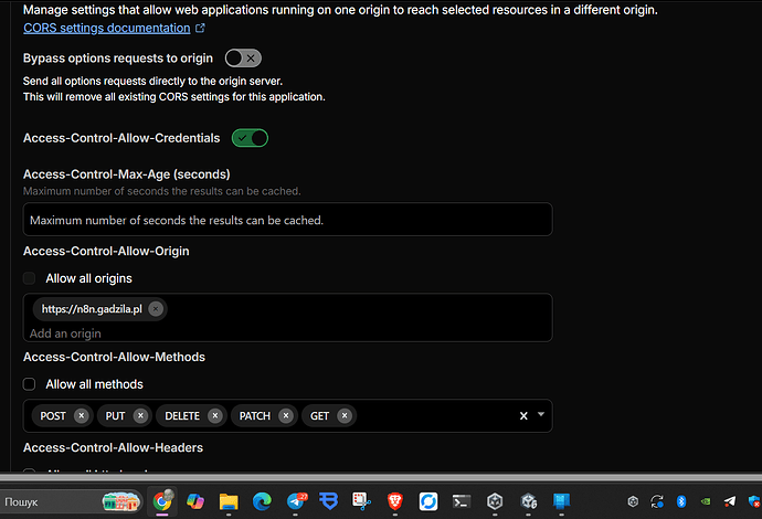

Thanks for the help. I followed the instructions (enabled N8N_SECURE_COOKIE=true, set up CORS, and configured the Bypass policy).
Current situation: The main interface works better now, but some critical parts are still broken:
  1. The Workflow Editor fails to load (I see frame-ancestors 'none' errors in the console).
  2. The Active/Inactive switch shows “Connection Lost”.

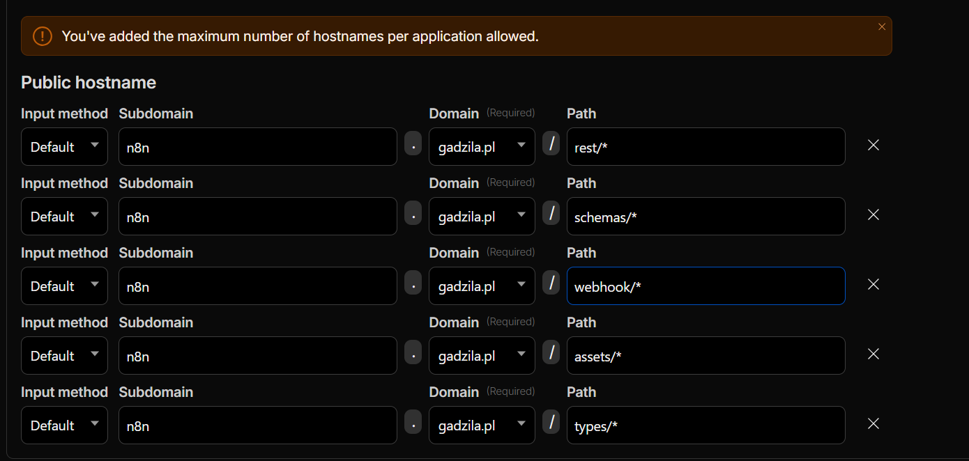

The main problem: I am on the Cloudflare Free plan, so I am limited to only 5 Public Hostname rows in the Access Application. Currently, I have filled all 5 slots with:
  1. rest/*
  2. assets/*
  3. types/*
  4. schemas/*
  5. webhook/*
It seems like I need to whitelist even more paths to fix the remaining errors (like the Editor framing issue), but I physically cannot add more rows.
Is there a way to optimize this list or a different workaround to bypass auth for all these static assets without hitting the 5-row limit?

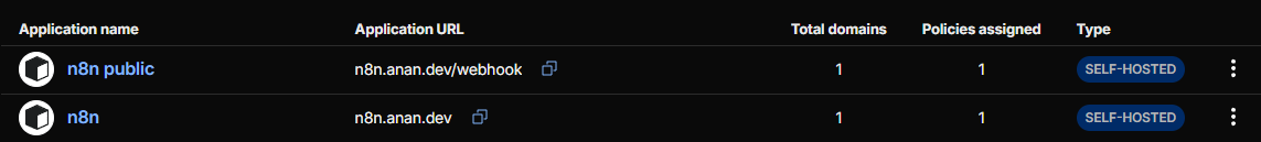

Hello @Hennadii_Melnyk,
I think you only need to whitelist the /webhook,
I don’t use Cloudflare Tunnel, I use Access control and only bypass /webhook:
and restrict the UI n8n.and it works without issuess.

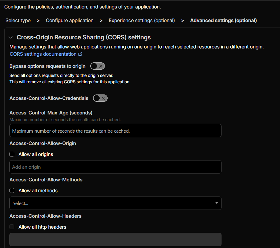

Also, there seems to be an option for CORS settings in the application configuration:
Maybe you can try configuring these,
In my case, I didn’t set anything and nothing is broken, but again I’m not using Cloudflare Tunnel.
Thanks for the reply. I already have similar settings in place

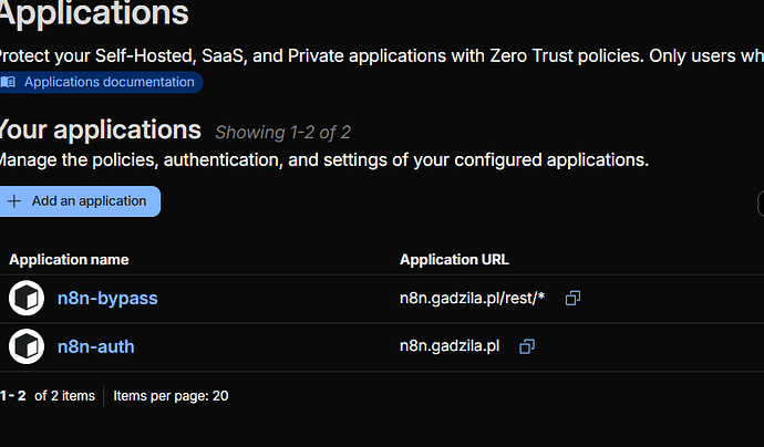

Thanks for sharing the screenshots.
One thing I’m noticing is that Cloudflare Access and other security rules are still being applied to n8n internal routes. In practice, this often causes issues on the Free plan, even when the configuration looks mostly correct.
A setup that tends to work reliably is bypassing Cloudflare Access only for the internal routes used by n8n, specifically /rest/* and /webhook/*, while keeping Access enabled only for the UI routes.
Additionally, make sure that Cloudflare security features such as WAF and Access are skipped for /rest/*. These routes are used by the n8n API and by the editor itself. There have been cases where 403 responses and editor-related errors were resolved by creating a rule to skip Managed Challenge, JS Challenge, Browser Integrity Check, or Security Level when the request host matches the n8n domain and the request path starts with /rest/.
Once /rest/* is fully bypassed at both the Access and WAF levels, the editor usually stops receiving redirects or security challenges on XHR and SSE calls, and issues like Connection Lost messages, a blank editor, or other UI failures tend to disappear, without the need to whitelist every static path.
