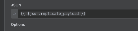

This is not what I see in your workflow. This is your Edit Fields node:
this is also not what I see in the workflow. This is what I see
You have to sync up what you are sharing and what’s in the full workflow JSON you provided earlier.
this is not true, it outputs a string with JS code
I can almost guarantee this issue is not a bug with n8n version 1.107.4.
After running the Edit Fields node and then inspecting the http request node I see this is what the http request’s JSON body looks like
This is still not a JSON, and because this isn’t, you get an error you get.
