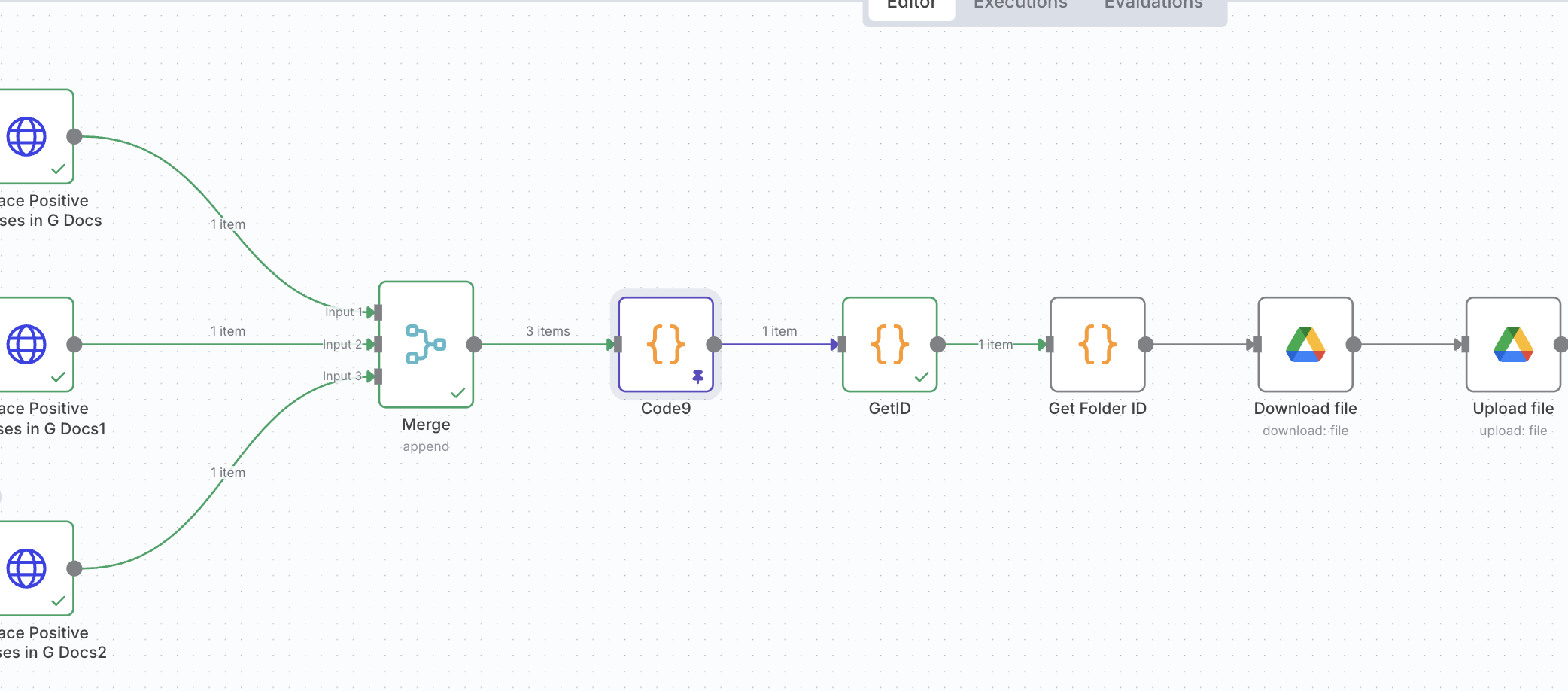

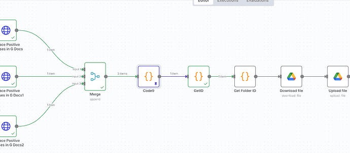

I have the node “Code9” pinned, but when I execute for example “Get Folder ID” it is still starting from the beginning.

I did it like that but it still starts from the beginning even if I click the small play button above the pinned node or nodes after the pinned one. :///

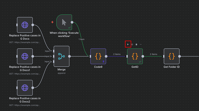

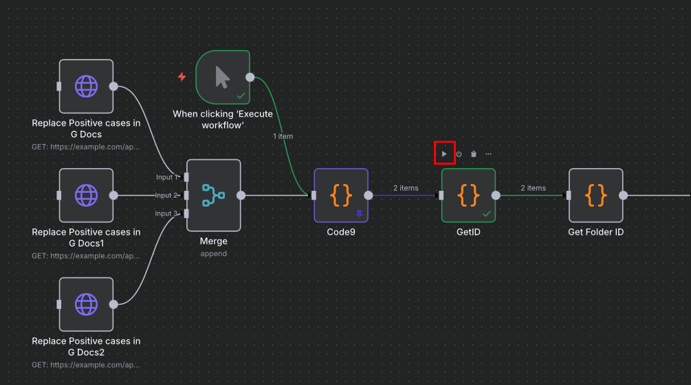

@Luca2 can you share your updated workflow. It should look something like below. The manual node needs to be set just before the Code9 node so that executing starts from there.
Clicking the play button above the GetID node will start execution from the manual node and run through the Code9 pinned node and then up until the GetID node.
