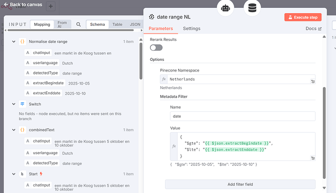

I have the same problem.
Same here.
Query: “looking for a market between 5 October and 10 October’” after normalizing dates to ISO (YYYY-MM-DD) format and applying ‘gte’ and ‘lte’ operators doesn’t work whereas ‘equals’ works fine.
In my opinion, this is a serious shortcoming that should be remedied quickly.
