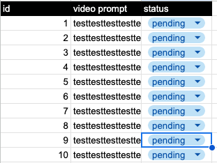

The video prompt is written in a Google spreadsheet.

Also, there are multiple images. The video prompt also has the same number of images.
For example, I want to process prompt 1 for image 1 and prompt 2 for image 2.

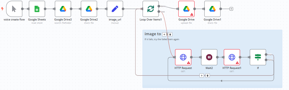

Will it run without any problems if I do it like the attached file?
I suggest including the Upload File and Share File nodes in the loop as well, so that the files are uploaded immediately.
When it comes to handling failed processes, it’s a bit tricky. You could handle it in this way, but there’s a risk of quickly ending up in an endless loop.
Personally, I prefer a different approach: storing the failed processes, analyzing what went wrong, and then processing these specific cases in a separate workflow. This could be done either with or without making adjustments to the prompt or the image.

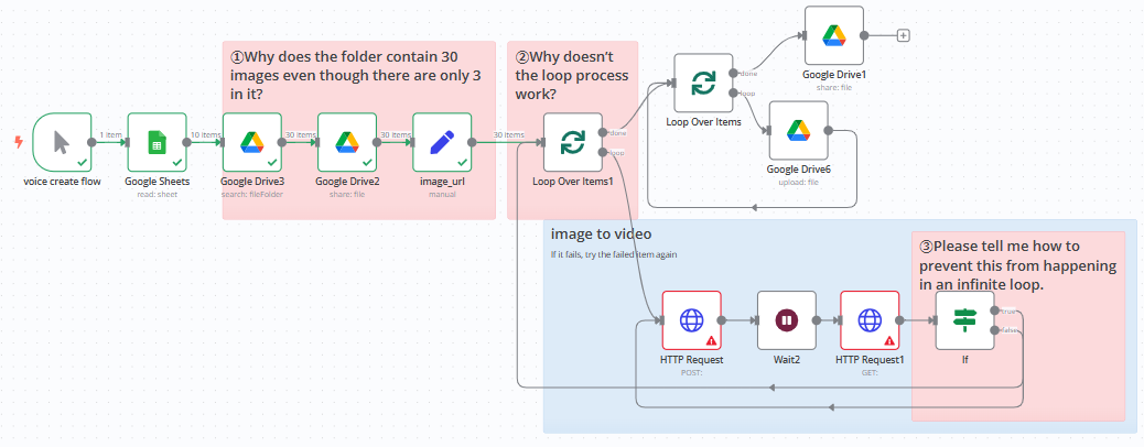

I tried adding a loop process, but I don’t know how to set it up in ➀, ②, and ③.
How should I set up and build the workflow?
I was able to solve ① and ②, but it’s taking a long time to build a flow to re-execute the failed image when ③ “fails”.
Please help.

About the endless loops: They occur when the same item is repeatedly processed by the same workflow without any changes or adjustments. If there haven’t been any temporary issues, then the same error will keep appearing over and over.

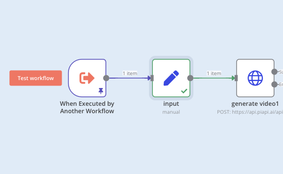

I created a workflow based on the sample.
Is this workflow okay?
Does the workflow successfully run when using When Executed by Another Workflow for a prompt and an image_url?
If it does, then there is a high chance it will work universally.
However, the image_url1 node relies on values from nodes that are only executed within the Schedule path, so it will definitely fail on retry.

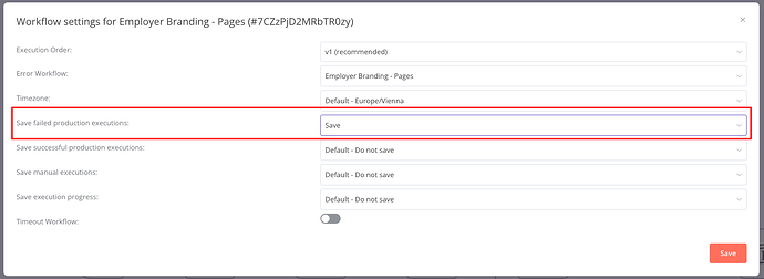

Can you enable saving failed executions
And check what failed?

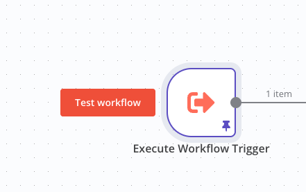

When you pin an image_url and a prompt to the Execute Workflow Trigger and hover over the node, than you can start workflow with the pinned data and debug the subworkflow.

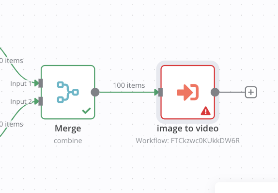

There is one thing that concerns me.
There are 100 items for 10 images and 10 prompts.
(Ignore the error because it’s just a screenshot from earlier.)
Also, in the above workflow, there is 1 item. Is 10 items correct?
10 images and 10 prompts with all combination are 100 unique items.
The Combine By can be changed to Position to match the items by their position. This matches the first item from input1 with the first item from input2, second item from input1 with second item from input 2.
Now there are 10 items!
