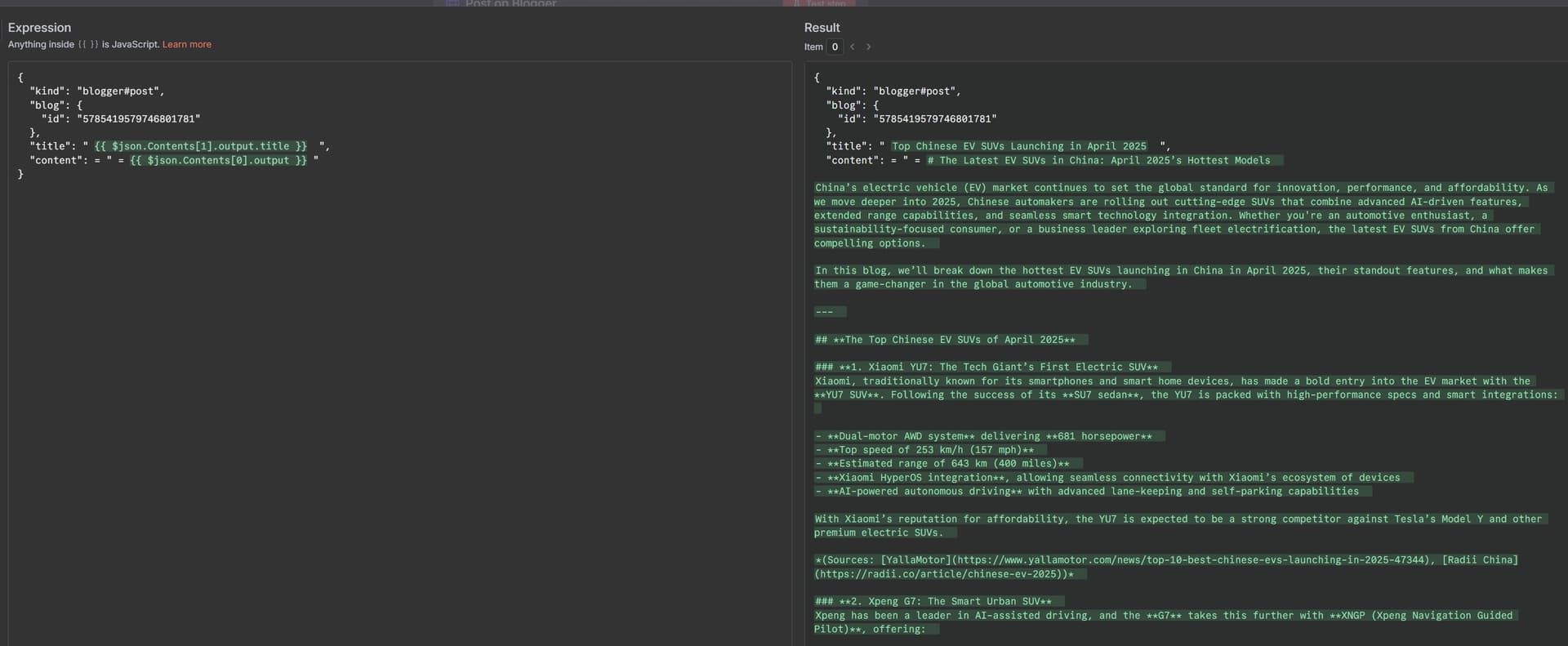

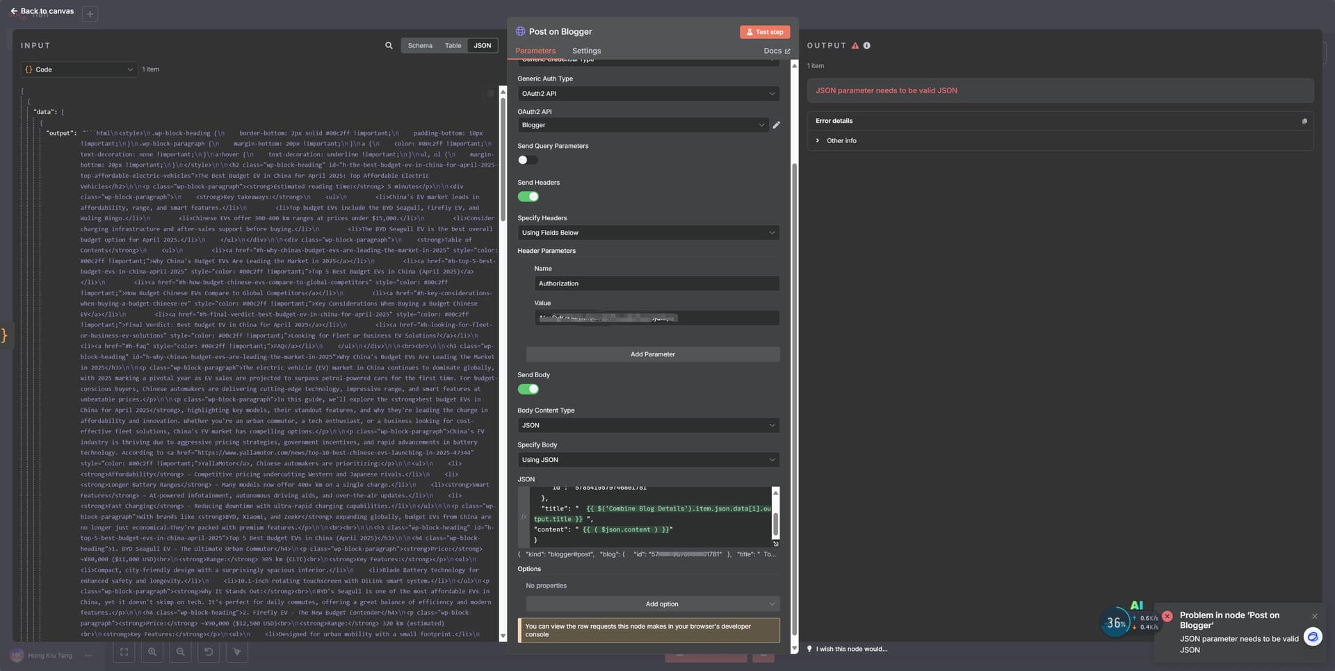

JSON looks fine and result was showing in the expression screen correctly, though when I tried to run it the error msg prompted “JSON parameter needs to be valid JSON”, please advice how I could fix it, I’m trying to use the Title and Contents and upload to blogger, thank you so much!

You have invalid JSON syntax:
"content": = "whatever" is invalid.
It should be "content": "whatever" (no equals character in the middle)

Hi @J_Tang
Edit your JSON body to:
  "kind": "blogger#post",
  "blog": {
    "id": "5785419579746801781"
  "title": {{ JSON.stringify( $json.Contents[1].output.title ) }},
  "content": {{ JSON.stringify( $json.Contents[0].output ) }}
Thank you so much, it works after changing to this:
“content”: {{ JSON.stringify( $json.Contents[0].output ) }}

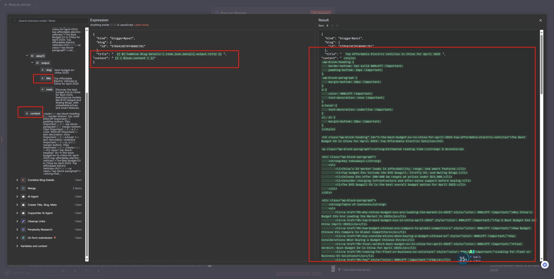

Hi all…I encountered the the same problem when I added a code note to remove the html blockers~~~~ The results are showing correctly inside the expression window but error occurred for JSON invalid…Please advice~~ Thanks!!
use JSON.stringify() again on $json.content so it escape characters like quotes (") and backslashes (\). which will cause issues with the json structure
Thank you all, should be like this:
“kind”: “blogger#post”,
“blog”: {
“title”: “{{ $json.data[1].output.title}}”,
“content”: {{ JSON.stringify( $json.content ) }}
