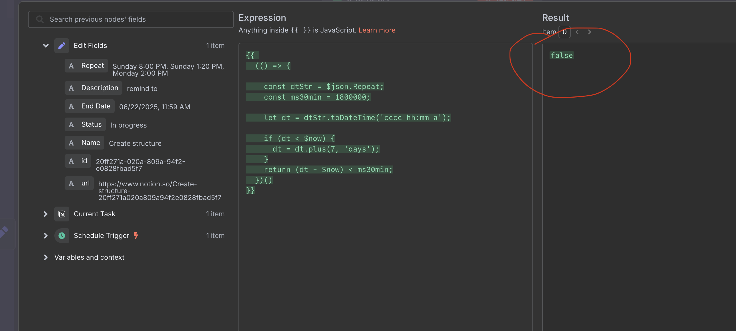

if the idea behind the code is to see if the time is within the next 30 minutes and you always assume that the input time is in the future, would something like this do:
    const dtStr = $json.Repeat;
    const ms30min = 1800000;
    let dt = dtStr.toDateTime('cccc hh:mm a');
    if (dt < $now) {
      dt = dt.plus(7, 'days');
    return (dt - $now) < ms30min;

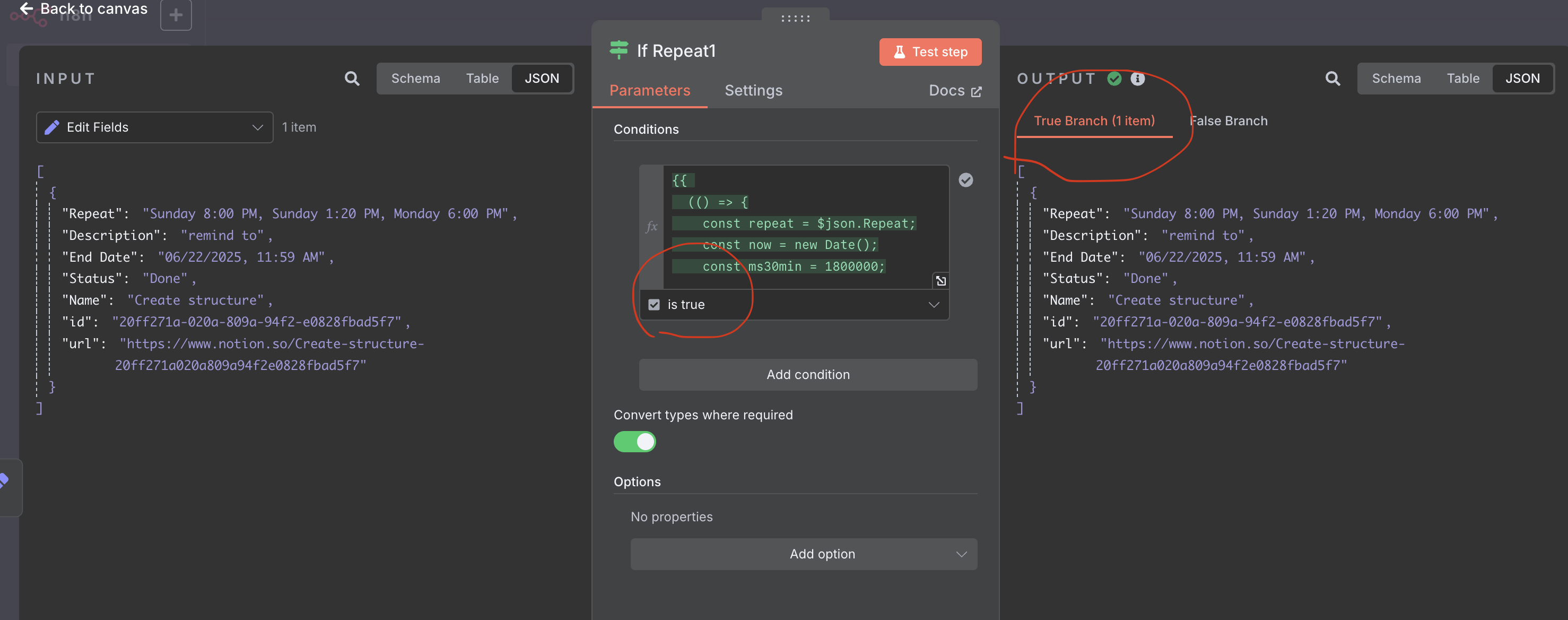

  • When the expression returns false, the value is shown correctly in the result — but the node routes it to the **true output`, which is clearly a bug.
So the issue doesn’t seem to be in the logic of the expression itself, but rather how the IF node interprets or receives the result.

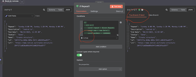

I’ve attached detailed screenshots showing the expression, its result, and the wrong routing by the IF node:
:paperclip: (see screenshot below)
The result is false.
the comparison was with true, but went to the true line

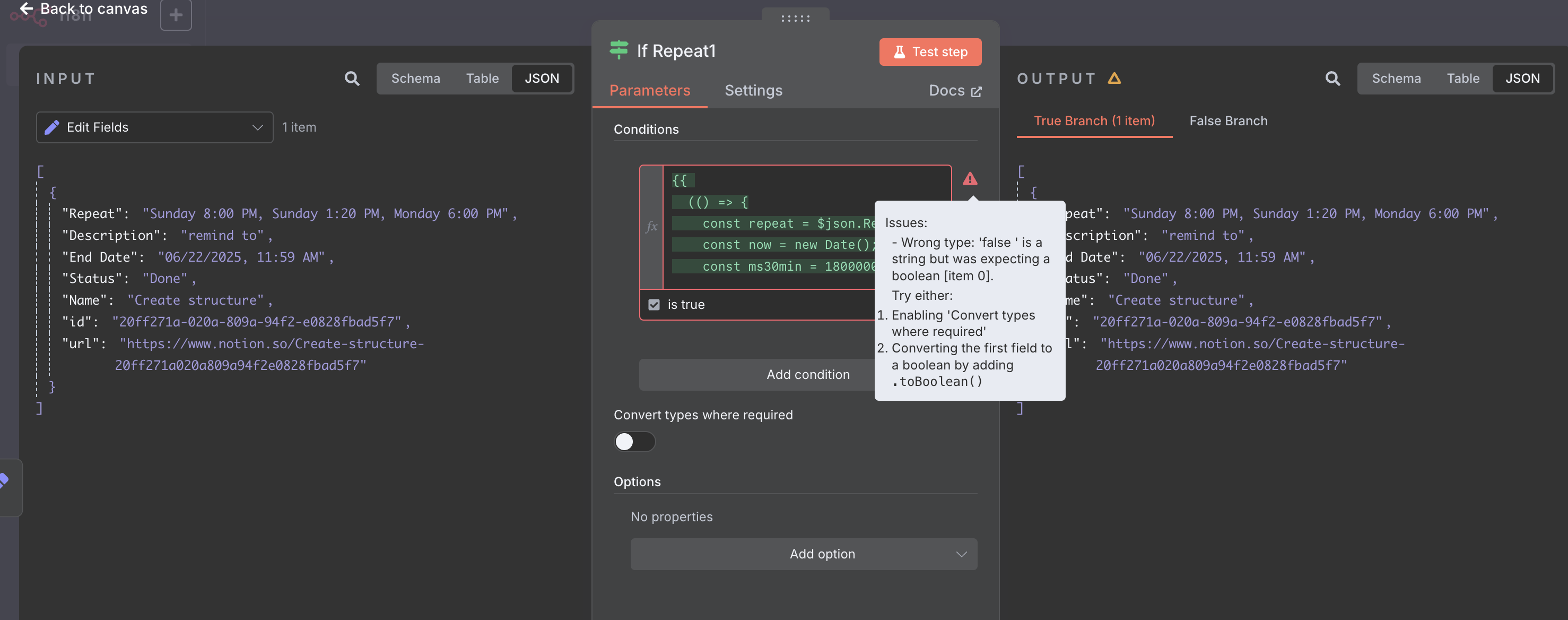

:warning: Strange type coercion error
Another oddity:
Even though my expression returns a boolean, the IF node throws a type error:
Wrong type: 'false ' is a string but was expecting a boolean
This only goes away if I turn on “Convert types where required”. Even the use of.toBoolean() doesn’t work
  1. My expression result (false) being misrouted to the true path
  2. The type error with "false" being treated as a string
I have the same code now, but it doesn’t get an error on types. I don’t get it. :see_no_evil_monkey:
