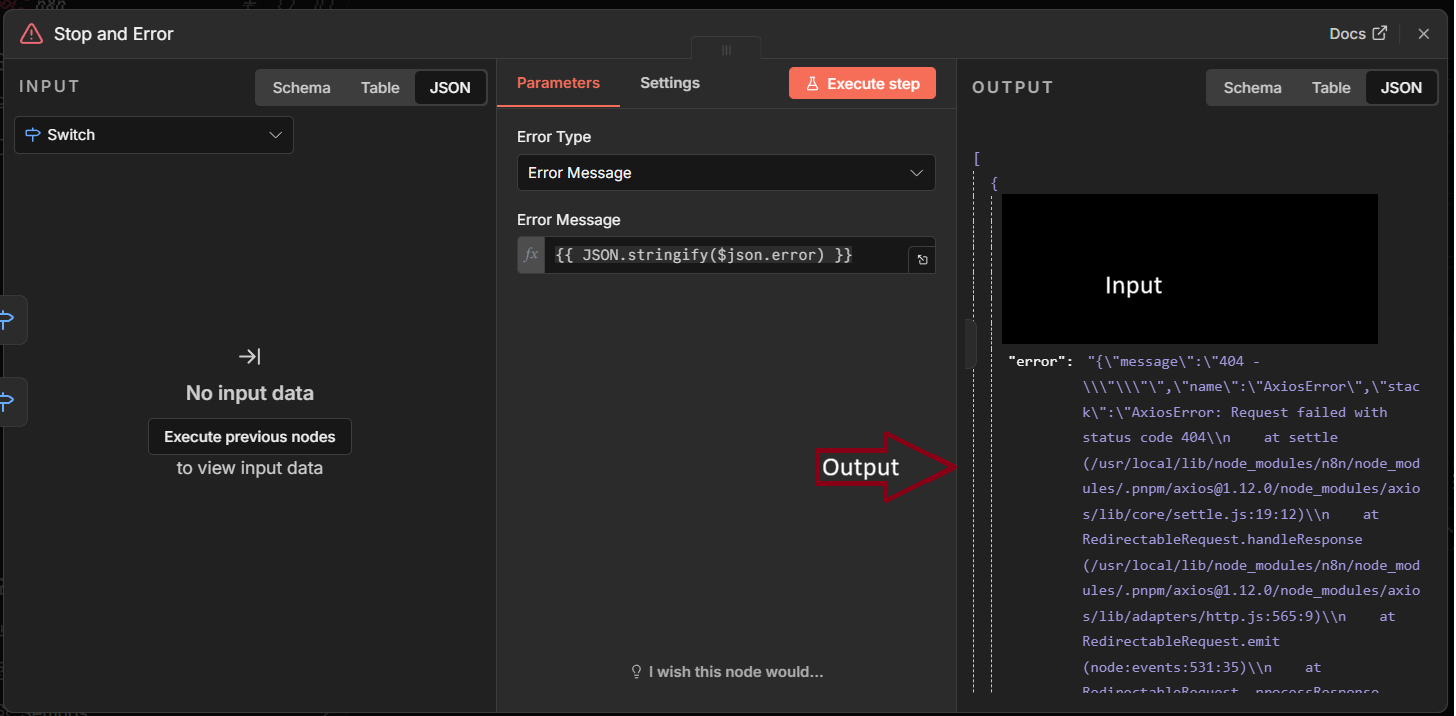

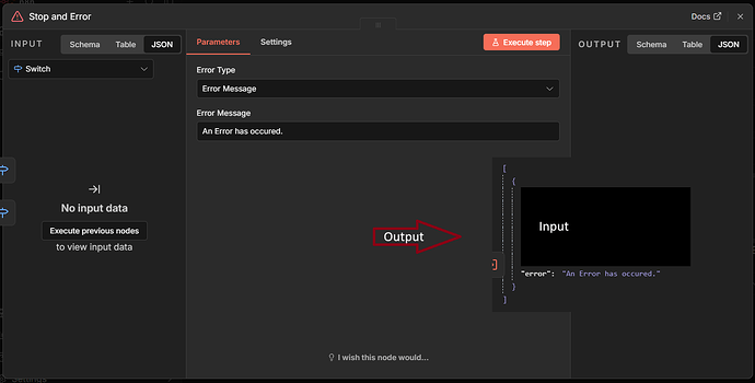

:white_check_mark: When using Error Type: Error Message, the parent receives an ‘error’ value with the message string. This is as I’d expect.
:white_check_mark: I can also use an expression along with Error Type: Error Message to populate the message or stringify the json. The behavior here also feels correct.

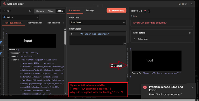

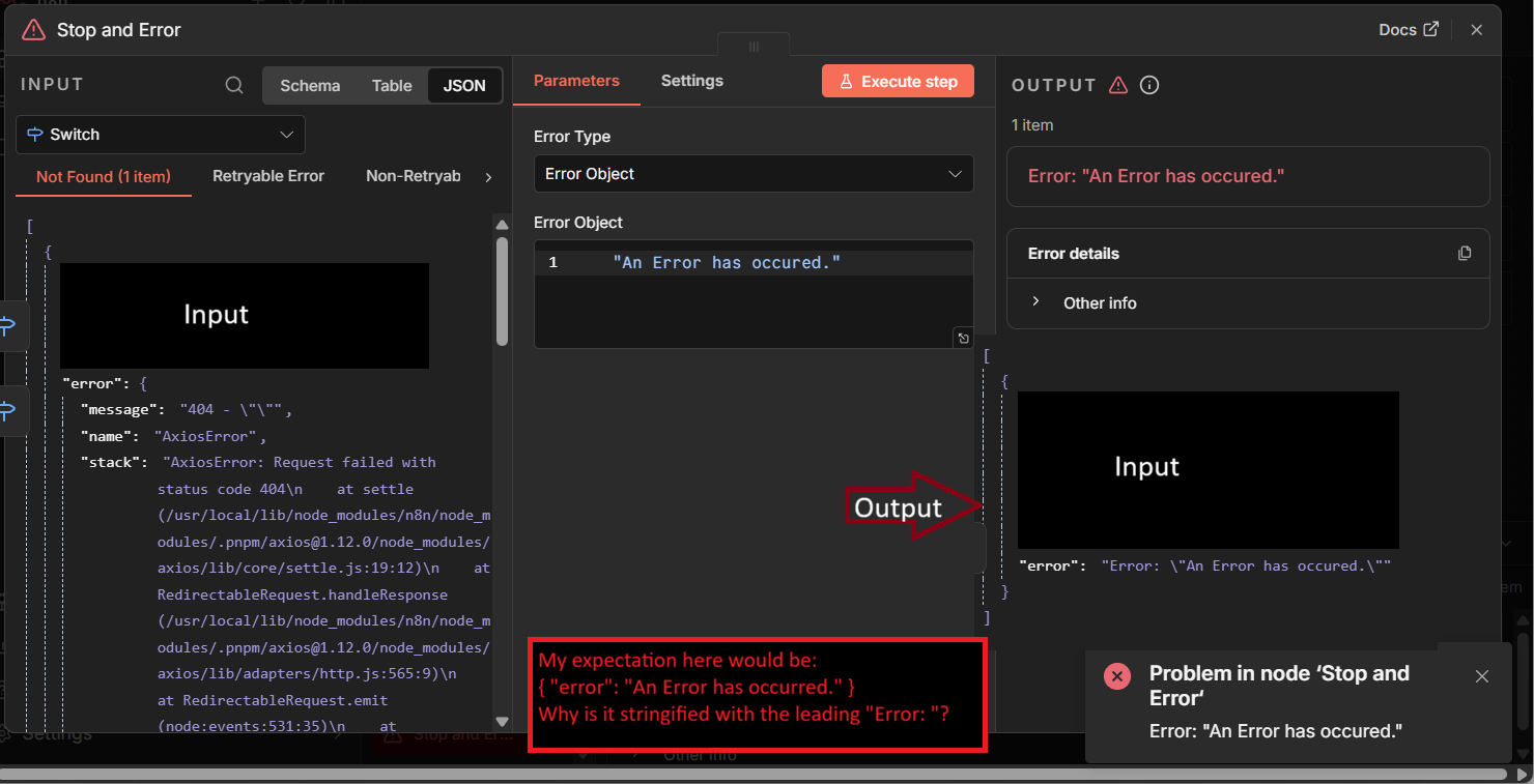

:cross_mark: Now if I switch to Error Type: Error Object, my expectation would be that rather than ”error”: “message” I’d receive output along the lines of ”error”: {…}. Here’s a very simple example, a string is a JSON object so:
Error Object: ”An Error has occurred.”
Expectation: ”error”: “An Error has occurred”
Reality: ”error”: “Error: \”An Error has occurred.\”” - an escaped JSON string, prefixed by an “Error:” string.

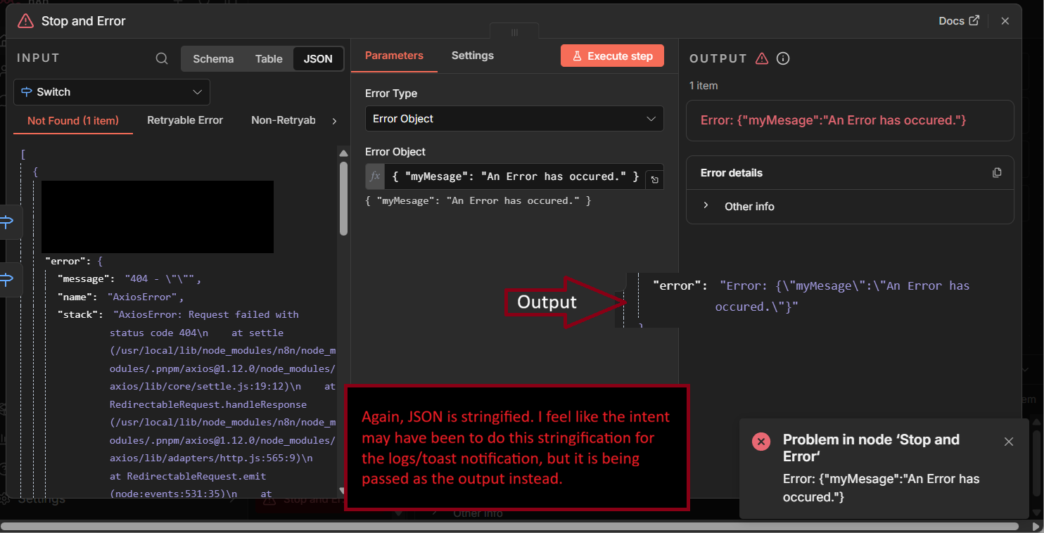

:cross_mark: I can’t even construct my own simple JSON error object:
Error Object: { "myMessage": "An Error has occurred." }
Expectation: “error": { "myMessage": "An Error has occurred." }
Reality: ”error": "Error: {\"myMessage\":\"An Error has occurred.\"}" - again, stringified JSON formatted into an “Error:” message string.

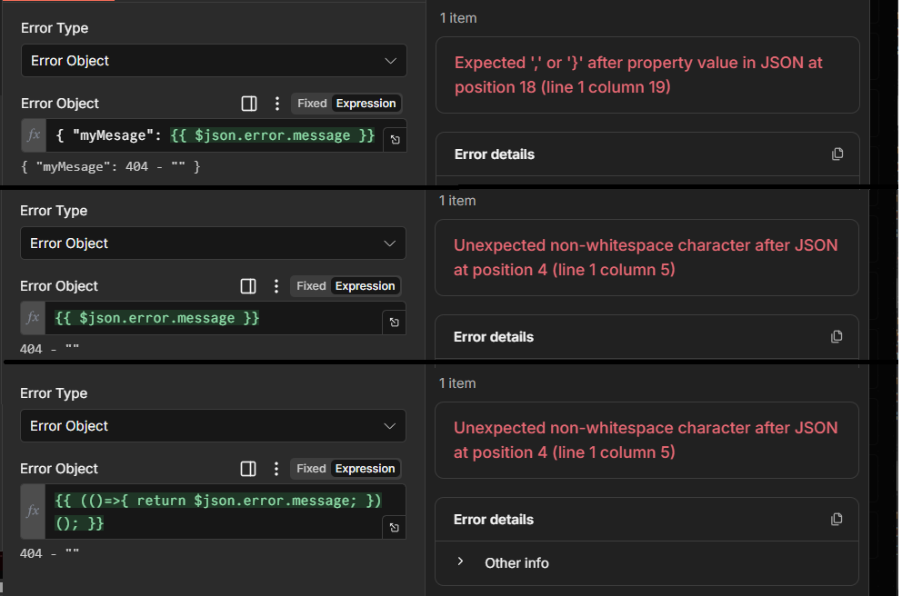

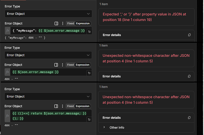

:cross_mark: It gets even worse when I try to use expressions within the Error Object. Any attempts to use or return javascript objects without stringifying them myself results in an error within the node.

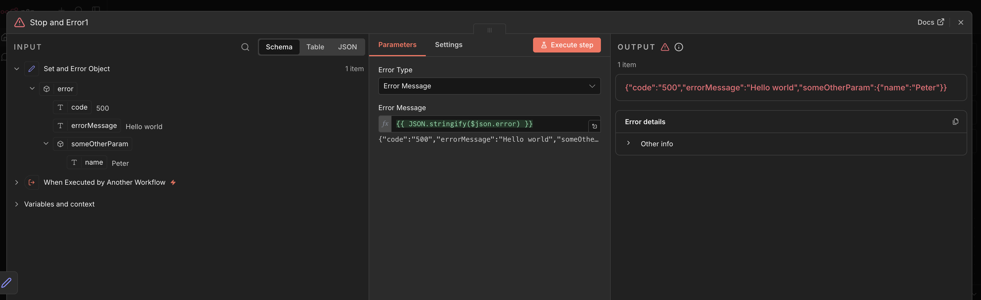

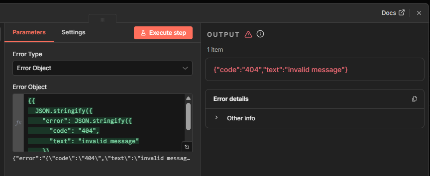

hmmm, i do not really know if it is a bug or not but what worked for me to preserve the structure is double stringifying while using the same error key:
  JSON.stringify({
    "error": JSON.stringify({
      "code": "404",
      "text": "invalid message"
This will still output a string:

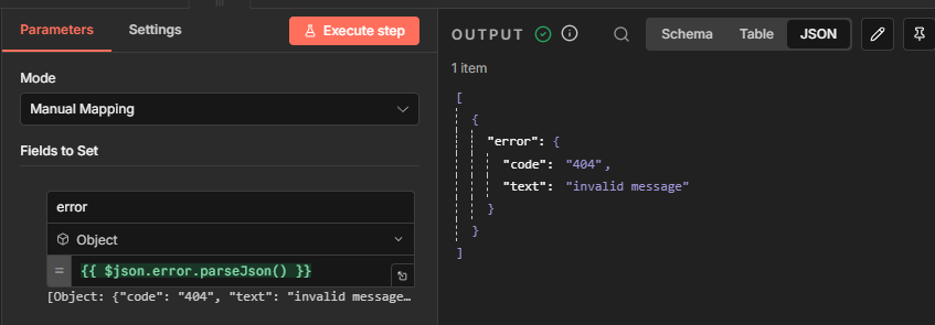

However you can parse the JSON in the subsequent step to get the object back:
I also notice the you can just get the similar result by selecting Error Type > Error Message and passing a JSON object there, it outputs the same outcome.
So It seems that the error key is designed to return a JSON string rather than a raw object..
Hope this can add some context..

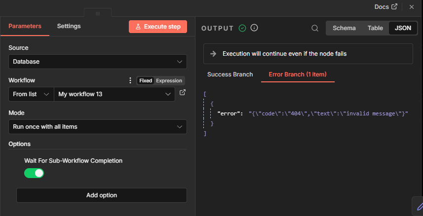

Hi @namante,
I think the issue you’re getting is that you are using non Error object property names which causes a JSON string to be returned instead of an Error Object. If you stick to the property names of the Error object, it should return correctly.
The key being the “message” instead of “myMessage”. This is because according to the documentation the Error Object option converts the error to a Javascript Error object.

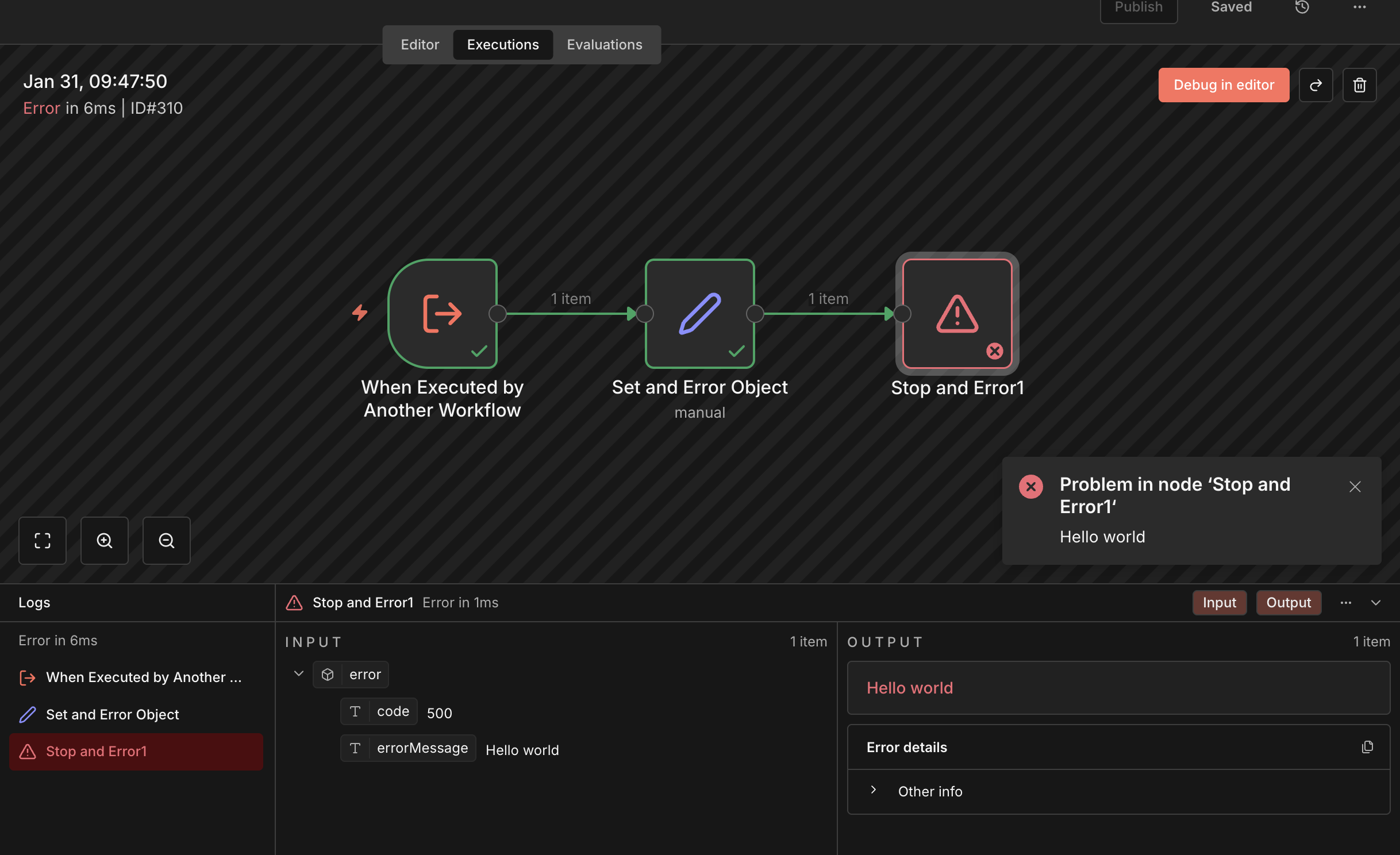

Child workflow throwing errors;
Parent wrokflow calling sub workflow

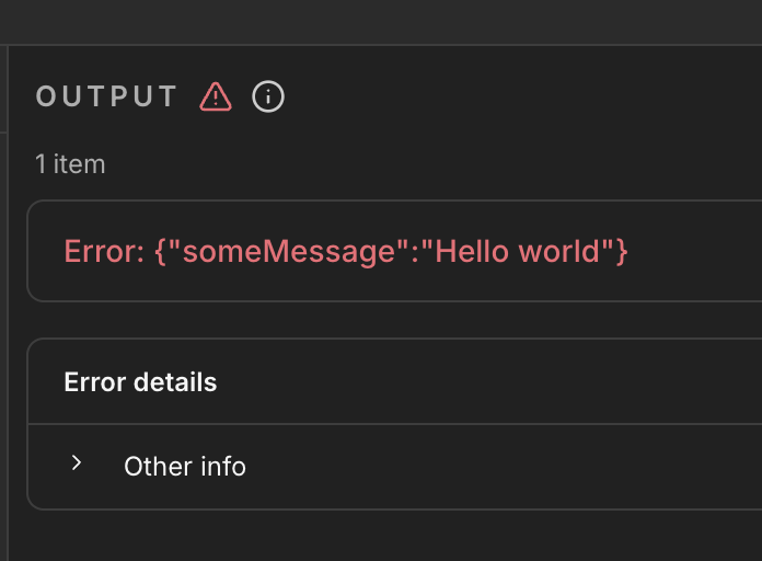

Hi @namante,
Ok I had to go fact check myself and yes it seems my understanding of the Error object was infact incorrect. According to the actual n8n codebase, it creates an object where “message” is either assign from “message”, “description” or “error” values if that is what you set in your object. It then further sets options with “description”, “type”, “level” and “metadata”.
So cause is not a valid param but message, description or error is if you want the error object to display “naturally” like in my screenshot.
However, when I pass in other params which does not contain message, description or error in the object, then it just returns a JSON string, especially if you did NOT include one of “message”, “description” or “error”, it’ll just stringify the entire object you passed
If you want to return a custom object to the calling workflow from the error node, then I would suggest doing it like below. Build your custom error object you want to return, then use the Error Message option and stringify the object. This will ovoid the Error Object option of prefixing the object with “Error: “

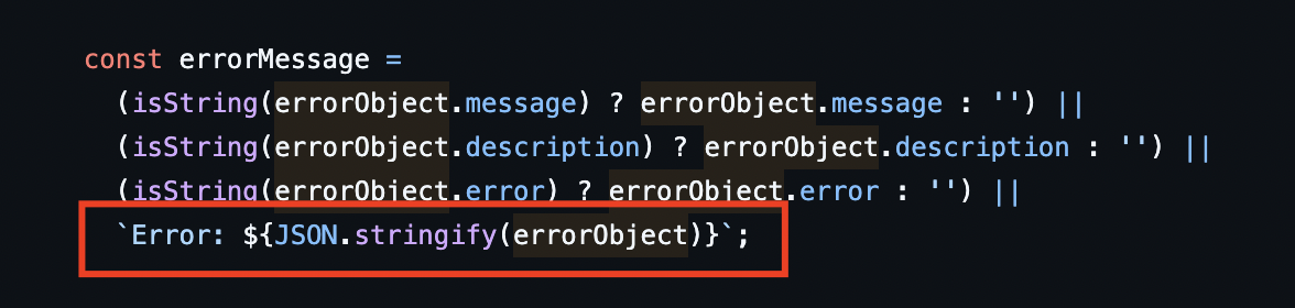

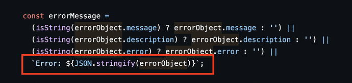

StopAndError/utils.ts parses out this ‘friendly message’ from the JSON object.
        const errorObject = jsonParse<JsonObject>(errorParameter);
		const errorMessage =
			(isString(errorObject.message) ? errorObject.message : '') ||
			(isString(errorObject.description) ? errorObject.description : '') ||
			(isString(errorObject.error) ? errorObject.error : '') ||
			`Error: ${JSON.stringify(errorObject)}`;
		return {
			message: errorMessage,
			options: {
				description: isString(errorObject.description) ? errorObject.description : undefined,
				type: isString(errorObject.type) ? errorObject.type : undefined,
				level: 'error',
				metadata: errorObject,
So if your object includes message, description, or error, it’ll throw that as a string. Otherwise it throws the entire json, stringified. It does return the full errorObject as 'metadata’, which gets set to this.context.metadata in the NodeOperationError object, but I’m not seeing if/how that’s ever exposed.
