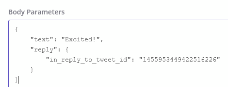

Hi @ronykris, from looking at the example in the documentation you have linked, the in_reply_to_tweet_id field should be nested inside the reply field:
Example: {"text": "Excited!", "reply": {"in_reply_to_tweet_id": "1455953449422516226"}}
So you might want to give the JSON/Raw Parameters option of the HTTP Request node a go:
This would be an easy way of adding a JSON structure to your request:
Thank you @MutedJam , I didn’t notice that option
It did the trick!
