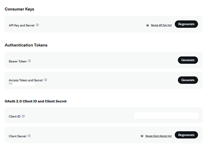

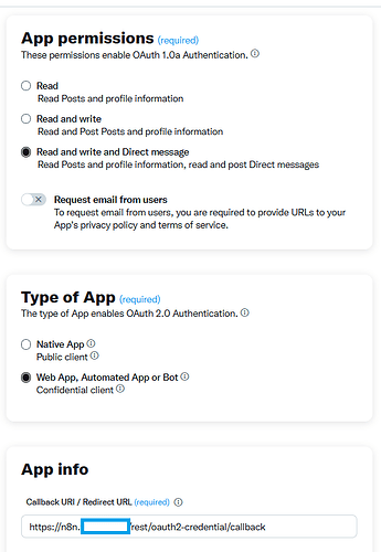

Could you please follow these steps to ensure the app is set up correctly?

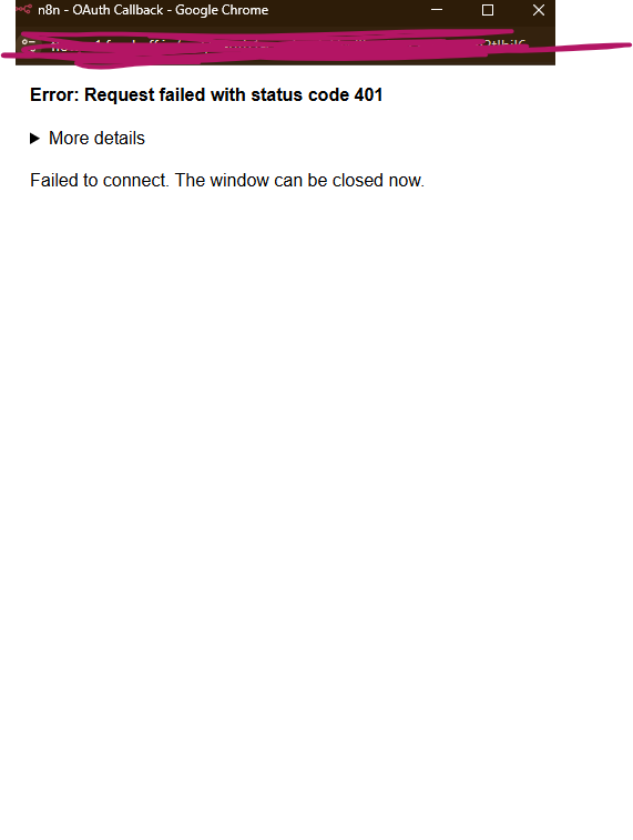

Authorization to the http node that you made has problem after accepting the Authorize app.
I have done everything a second time just to make sure but same error. You are using OAuth 2.0 Client ID and Client Secret right? its the only id working for me.

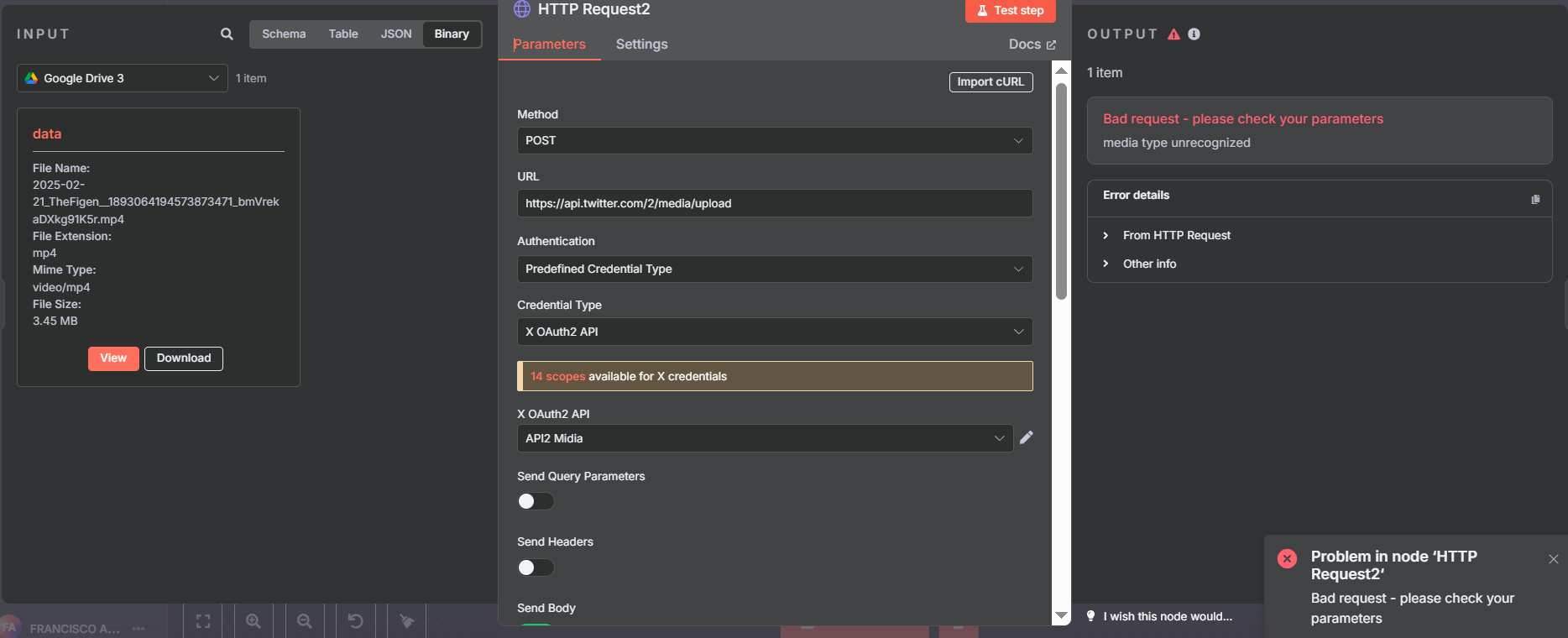

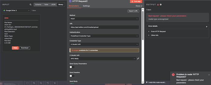

Hi my friend, I managed to configure it without any problems, it was very good, congratulations!!
I would like to know how I can post videos, I tried to adapt the HTTP Request node to upload media, but it keeps giving me the error “Bad request - please check your parameters
media type unrecognized”
If it is possible for you to answer me with a solution, I would be very grateful!!!
