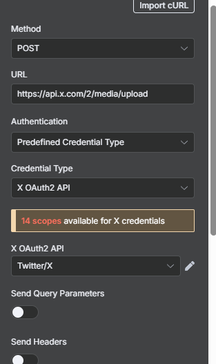

Please try it with https://api.x.com/2/media/upload

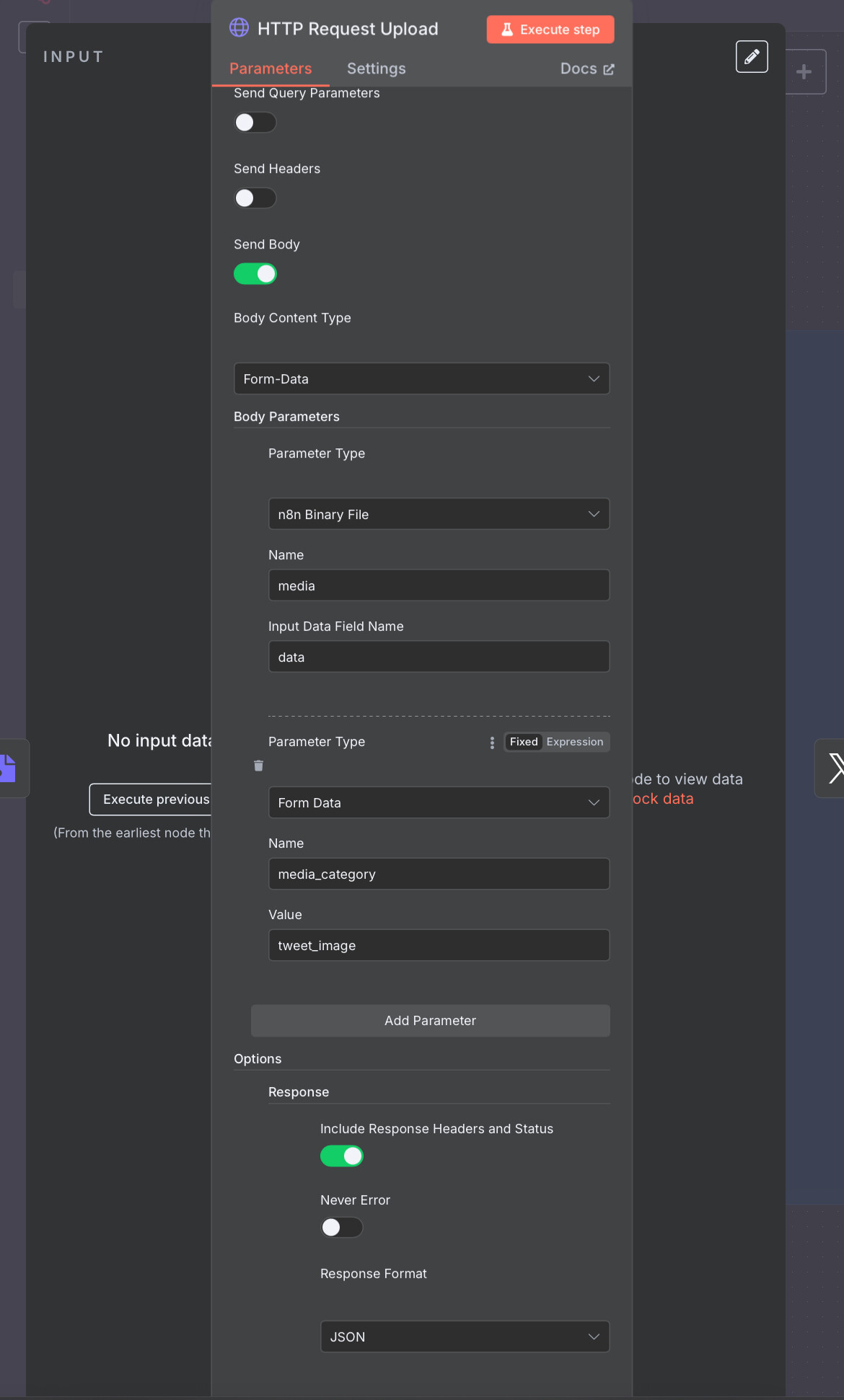

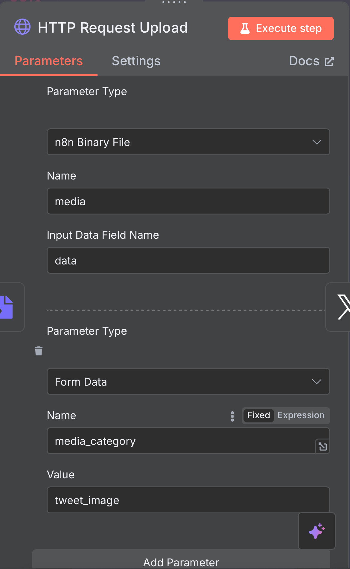

I basically just adjusted the URL (used “x” instead of “tweeter”) and added media_category and tweet_image to the body parameters.

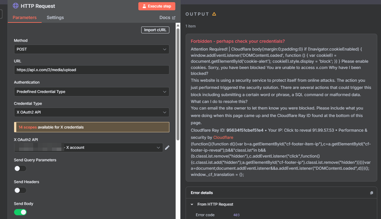

Unfortunately, I am still having issue with Cloudflare (((
Is it possible, that I am experiencing this issue, because I am using the self-hosted version of n8n?
I tried with n8n cloud and I’m having the exact same issue so it’s not related to self hosting.
I’m having the exact same issue. Did you find a solution?
It works fine when I use python or Node.JS locally. So probably due to the fact that Cloudflare blocks datacenter IPs
Ok. It wasn’t a credential or Cloudflare issue, actualy. I think n8n just couldn’t find correct explanation )))
So, @Philippe_Greenleaf , maybe you have the same issue. The problem for me was that I was mapping Image from the Google Drive. But somehow, that image had a wrong File Extention and naming. I added an edit Node to fix it. And it works )))

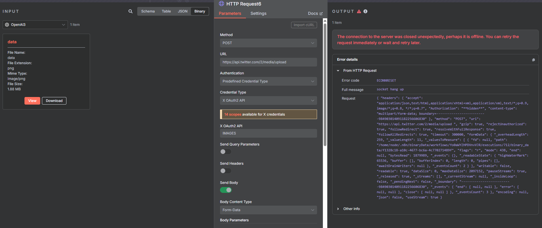

hopefully some can help out here, I followed the instructions and it works fine when manually executing workflow it posts image to x no issues.
the problem is when this workflow triggered by a scheduler it fails with an error
“The connection to the server was closed unexpectedly, perhaps it is offline. You can retry the request immediately or wait and retry later.”

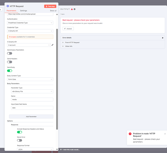

I am facing the same issue. Kindly tell me how did you resolve it . I have successfully set my credentials and body but it is still giving me bad request error.
Thank you so much it really help me to resolve bad request error.

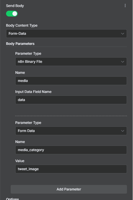

I have configured Twitter module which was working fine even without adding media_category and tweet_image to the body parameters but suddendly it start giving error. Now after adding media_category and tweet_image its working correctly.
I see you have still https://api.twitter.com/2/media/upload in your URL instance of https://api.x.com/2/media/upload.

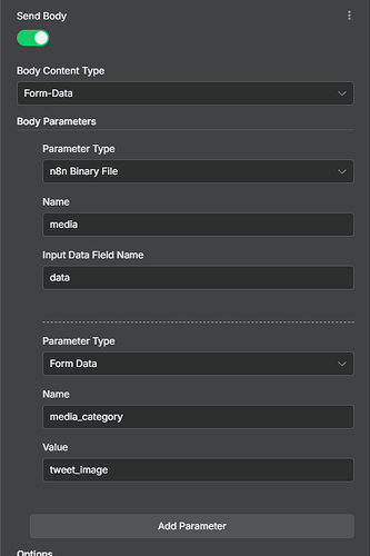

And make sure to have
„media_category“ and „tweet_image“ in the body

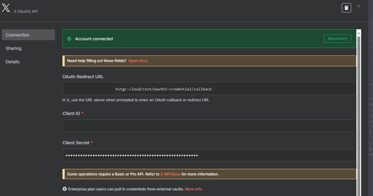

Hi guys, I’m still facing the error “Forbidden - perhaps check your credentials?”
My connection says it’s ok, I created Body Parameters taking in consideration recommendations from this thread post.
Anyone can give some feedback on what i have wrong?

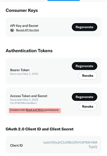

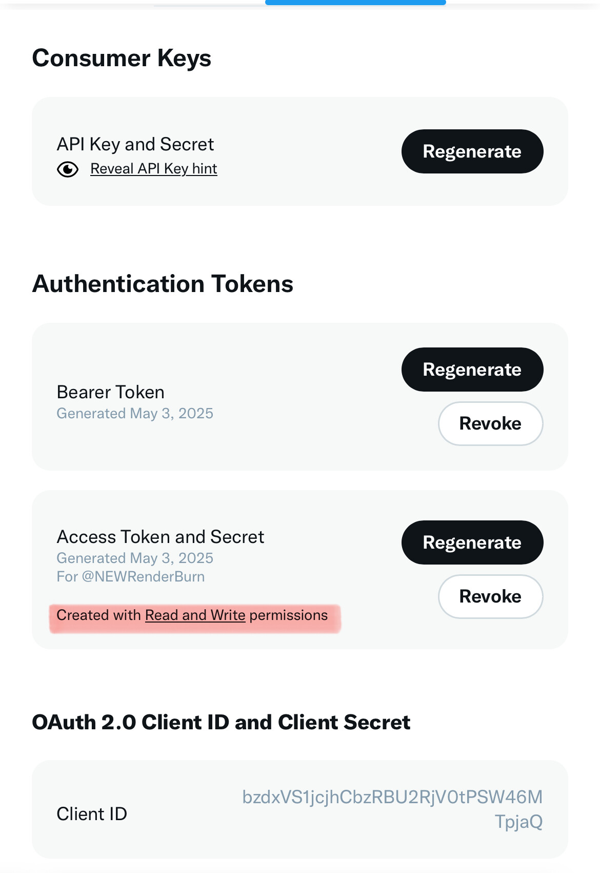

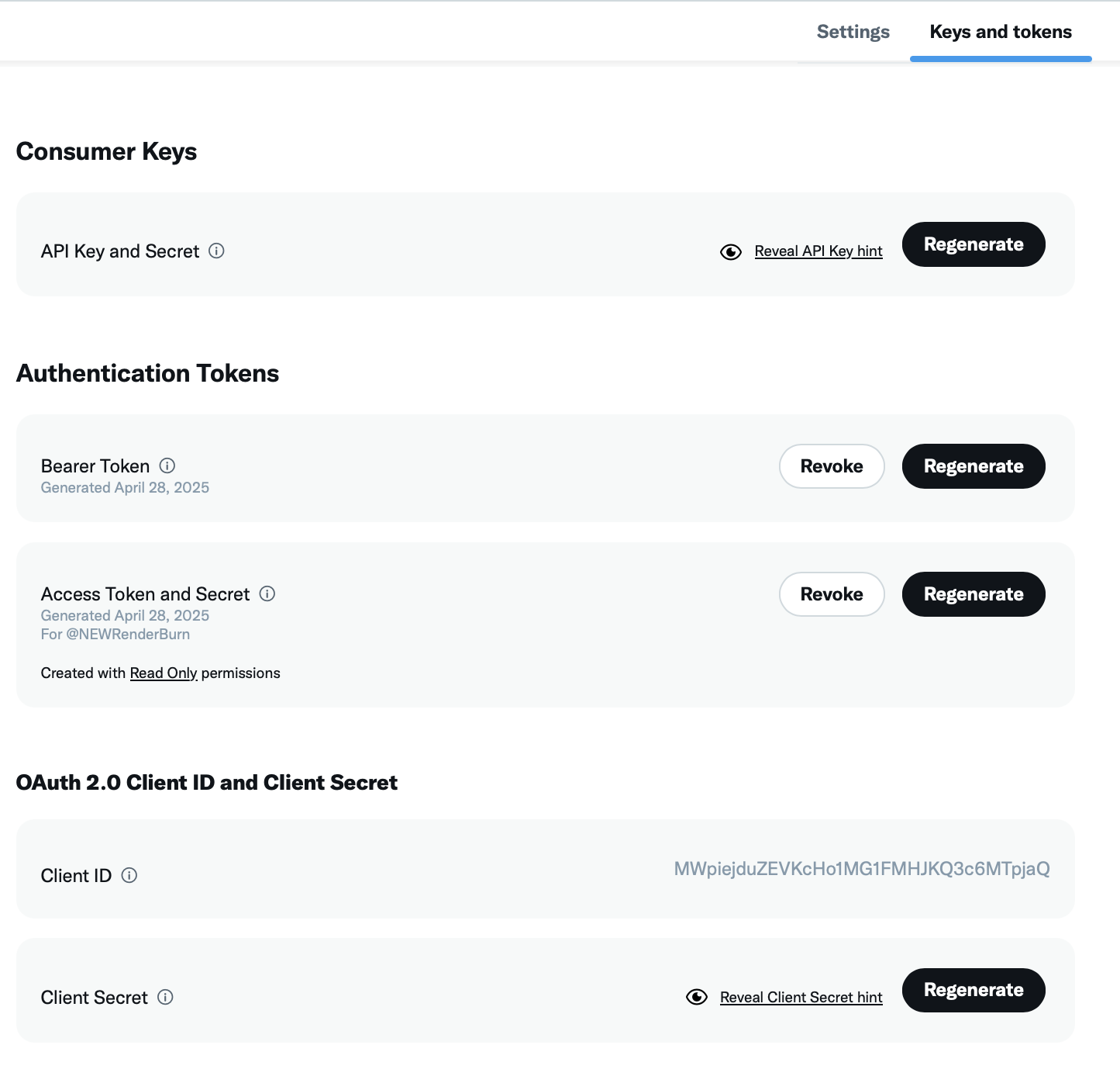

Make sure that in 𝕏 developer portal it is set to at least “read and write”. Preferably “read, write and direct message”
If it doesn’t stay selected (sometimes a bug), try this:
New Tokens on 𝕏
  1. Delete the app
  2. Create new app without “User authentication set up”
  3. Generate “Access Token and Secret”
  4. Set up the “User authentication set up” with “read & write” permission
  5. Regenerate every Token
I just did some texting and if I use the main X/twitter node to send a simple text tweet it works.
If I use the http request to insert the image as binary data, it gives me the “Forbidden - perhaps check your credentials?” and I’m using the same X OAuth2 API for both scenarios.
Also, I did validate and I already add the “User authentication set up” as "
Read and write and Direct message".
