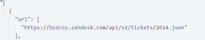

I am trying to insert extracted data into a postgres db but the node seems to add “{}” characters.
What am I doing wrong?

It kind of makes it tricky to see what the value of the URL string is there, It does look like it might be different from the zendesk URL in the first screenshot though as it isn’t an array.

This is what appears in the database:
{https://***.zendesk.com/api/v2/tickets/2614.json}
I wonder if it is because the item is an array, what happens if you use a set node first to set the value and pass that to the Postgres node
