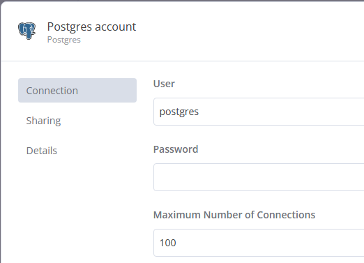

This is just a wild guess, but there’s a chance this is related to a recent change in the Postgres Credentials item that sets maxConnections (presumably to control a pooled connection count).
Open your Postgres credentials node and if the Maximum Number of Connections parameter is there, defaulted to 100, you might try increasing OR decreasing that to see if that affects how your workflow execution goes.
Thank you, we tried both increasing and decreasing the maximum number of connections and still receive the same errors. It seems as if it may be related to the following issue? Postgres node with ssh tunnel - random Connection refused · Issue #12807 · n8n-io/n8n · GitHub
