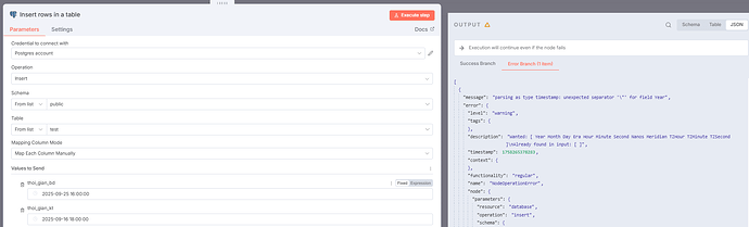

I using Postgresql Insert node, but it error when column type is timestamp
I have the input date in ISO 8601 date string format and I keep getting an error.
Input of Insert node
Output of Insert node

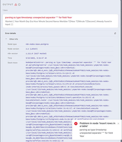

Error Message:
parsing as type timestamp: unexpected separator ‘"’ for field Year
Wanted: [ Year Month Day Era Hour Minute Second Nanos Meridian TZHour TZMinute TZSecond ] Already found in input:

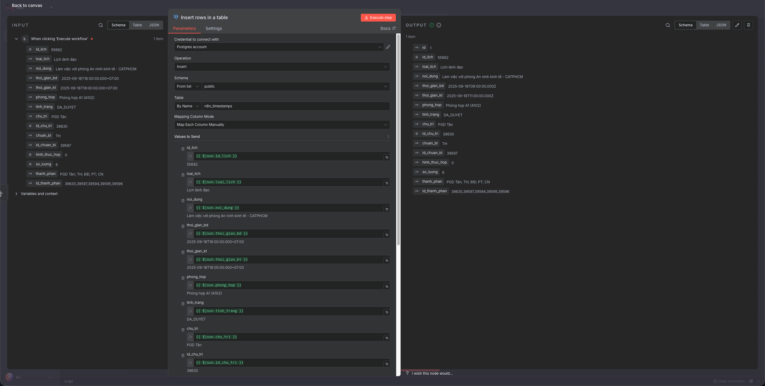

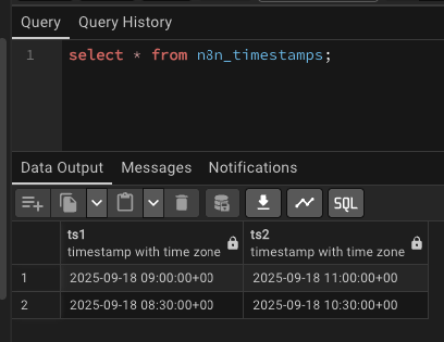

Took your input data and populated my db with it.
My DB:
Workflow:
Result:

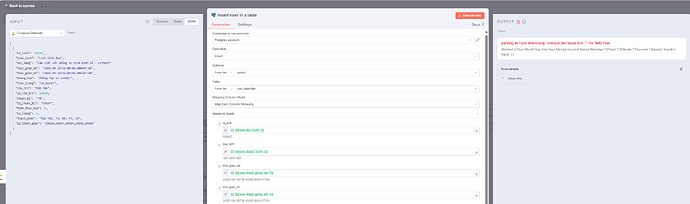

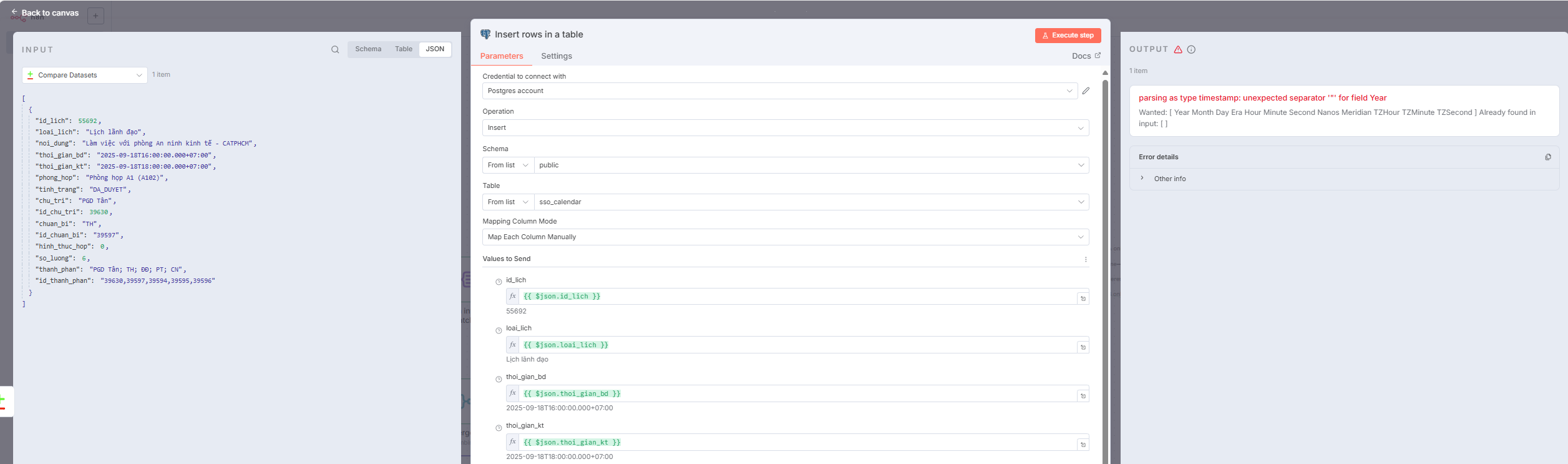

This is my input
Can you copy and paste your workflow here?
here

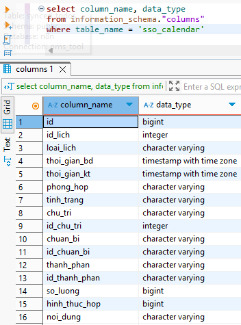

CREATE TABLE public.test (
	id serial PRIMARY KEY,
	thoi_gian_bd timestamp without time zone,
	thoi_gian_kt timestamp without time zone
