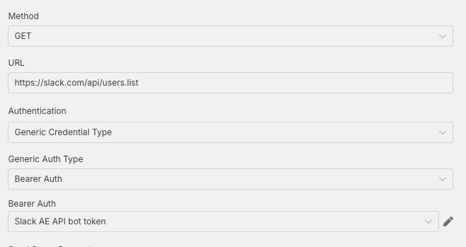

Here’s the node setup:

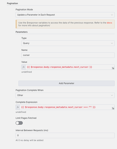

Here’s the pagination specific setup:
Note: these are all green when I first setup the node and make the first request without pagination. But as soon as I add the pagination logic, and fire the request I get the error output you see below.
The output of the node changes from the list of users to this:

I am having the same issue using Bearer auth with the Rocker Validator API. I’m able to make a successful request to the API with pagination turned off, but when I add the pagination option, I get an “Invalid API token” message back, which leads me to think that paginated requests aren’t adding the Authorization header, or adding it incorrectly.
I’m experiencing the same issue with API requests and pagination. Adding the Bearer token to the ‘Header Parameters’ works as a temporary solution, but ideally this workaround wouldn’t be necessary.
