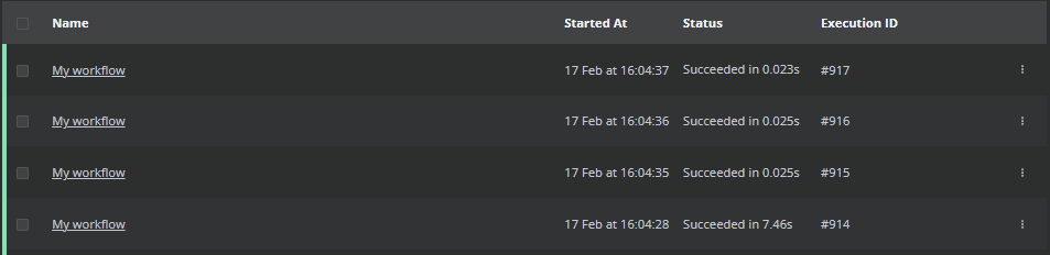

I’m using n8n to build a WhatsApp virtual assistant. Everything works as expected, but I noticed that each message sent to the test number triggers three additional executions:
After reading the Meta documentation, I found that when the Message API is activated, status updates are also sent. The executions are:
#914 - The sent message
#915 - Status sent
#916 - Status delivered
#917 - Status read
To avoid errors in the execution history, I added an If node to advance only if the “message” array exists. However, this doesn’t prevent the Webhook from being triggered, which still consumes my execution limit. Is there a way to avoid this situation? I saw a similar topic without a solution to this.

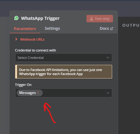

What do you have enabled here?

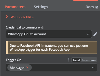

My WhatsApp trigger has only Messages enabled, just as yours:
Hey @Murilo_Lima_Alves,
I just checked WhatsApp Webhook documentation and unfortunately there’s no current solution for your problem.
You will receive extra events =(
