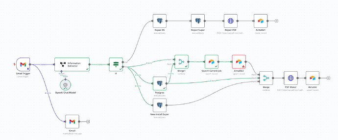

Long time listener, first time caller. I constantly run into the undefined value from pervious nodes.
Some data goes straight through the workflow just fine, but as soon as I use nodes that search for records some things go off the rails. Most of the problems seem to arise when I try to use Airtable nodes. This workflow is fine when its only processing one item.
I’ve rearranged and connected nodes in all kinds of ways to try to get the previous node data to work the right way. I’m feeling frustrated.
It says that I’ve exceeded the character limit when I try to share my workflow.
Error: Multiple matching items for expression [item 0]
In the second Airtable node that is supposed to upsert a record.
For anyone that comes later. I solved it with a loop. The n8n documentation mentions that some nodes will not iterate through each item and you have to use a Loop node to deal with each item. Mostly database nodes.
It doesn’t mention Airtable search or upsert nodes though. Maybe I was doing something wrong, but the loop node made everything work.
