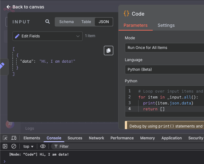

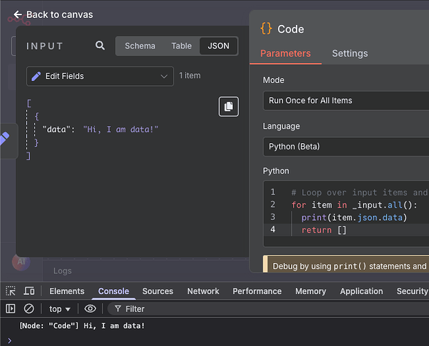

Hey @hawkar hope all is well and welcome to the community.
See if this example helps with printing from the python script
If this doesn’t help, please provide your example / exact use case.

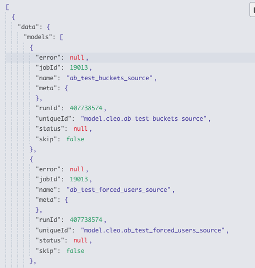

Hi, yes that works because your printing scalar values, but when you print a Python dict (an object in JS) it doesn’t work. In JS you’d use JSON.stringify() to convert the object to a string and make it visible in the console. But in this case we have JSON → Python → JS Object.
My data looks like this:
If I try to print the individual values it works, but printing an object, like each model in the screenshot above produces [object Object] in the console.

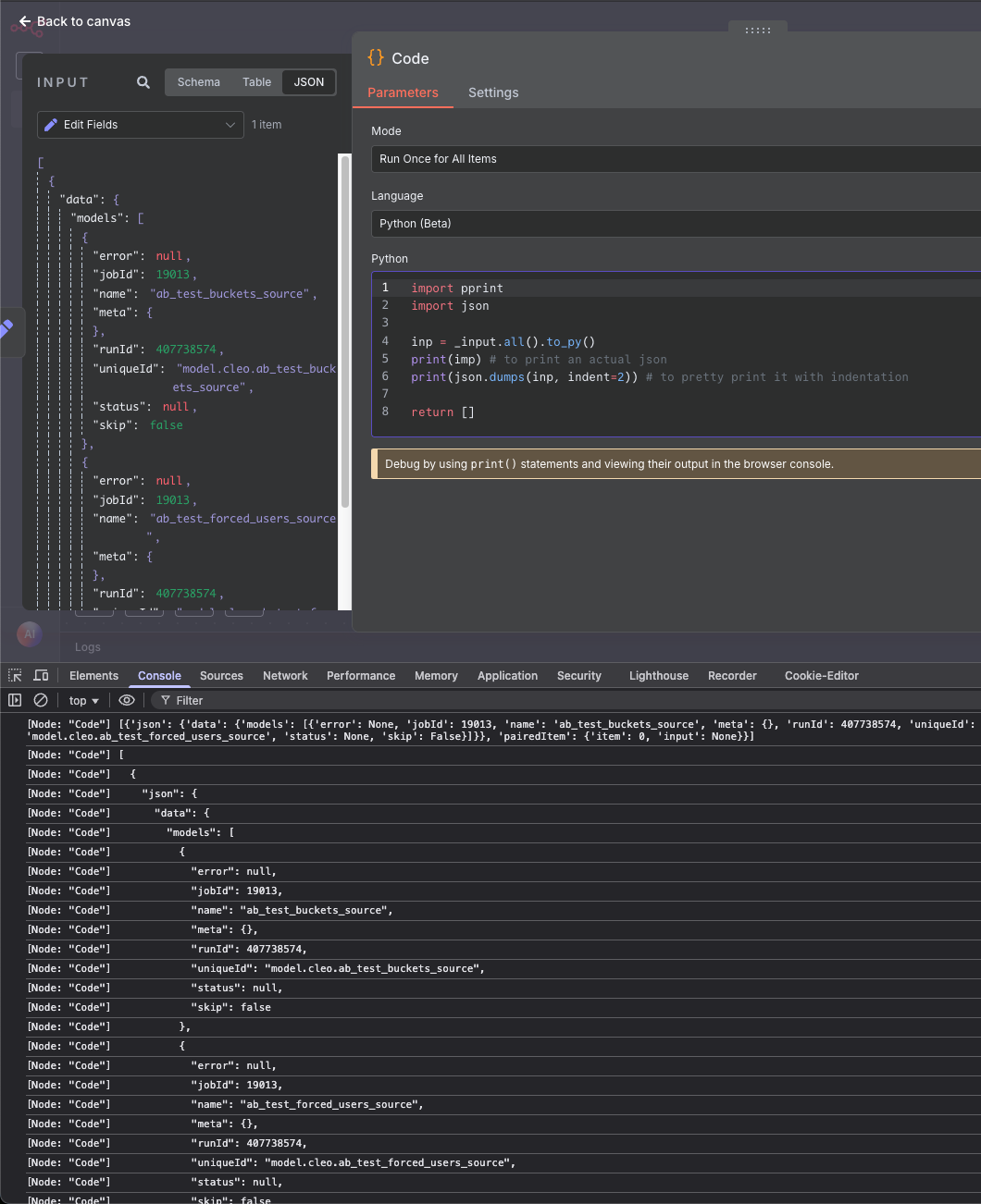

See if this helps then
This doc is just about that.
