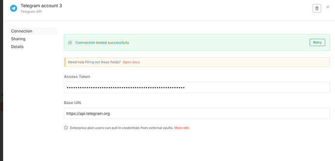

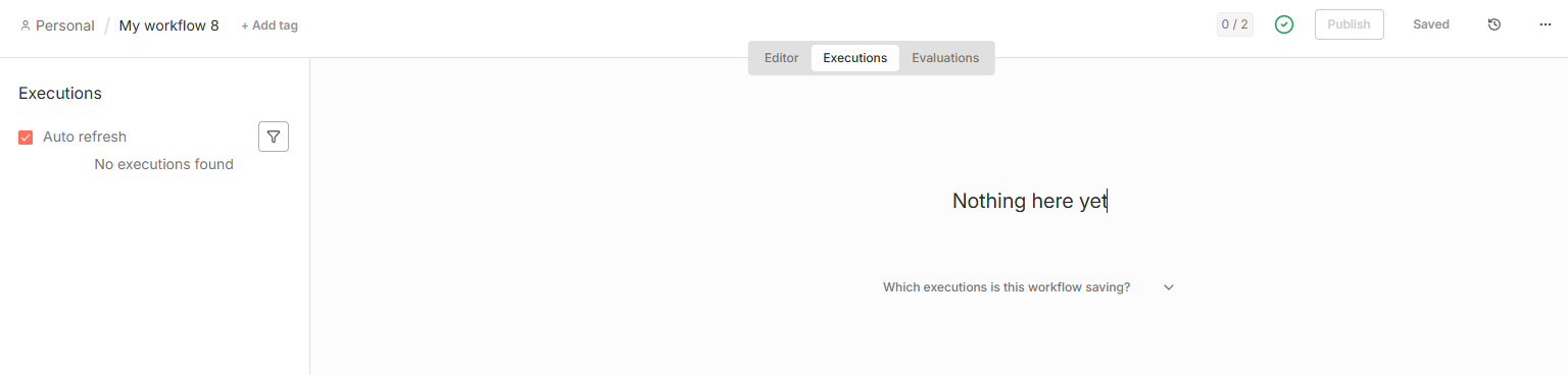

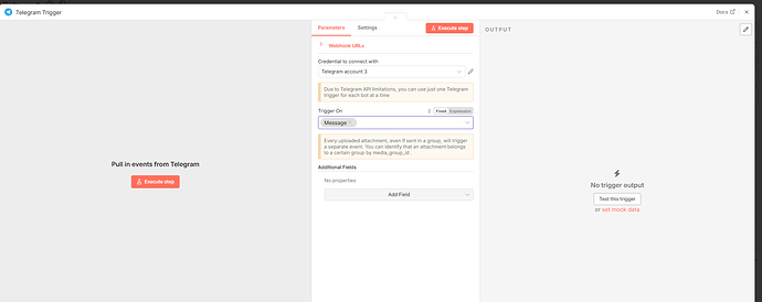

I’m having this problem. I created a bot on Telegram. I connected to N8N. The connection was successful. I added a node trigger message. I clicked save, then publish. I sent a message on Telegram in the newly created bot, and there was no response from N8N.

Did you set your WEBHOOK_URL env variable as well?
