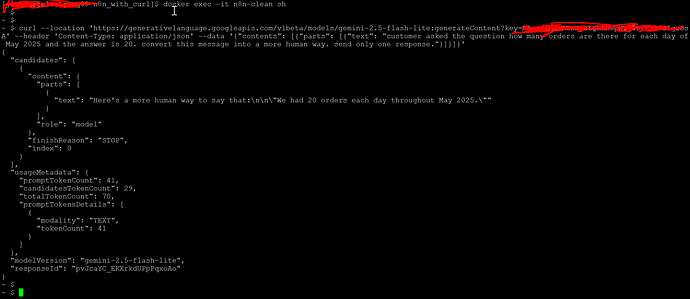

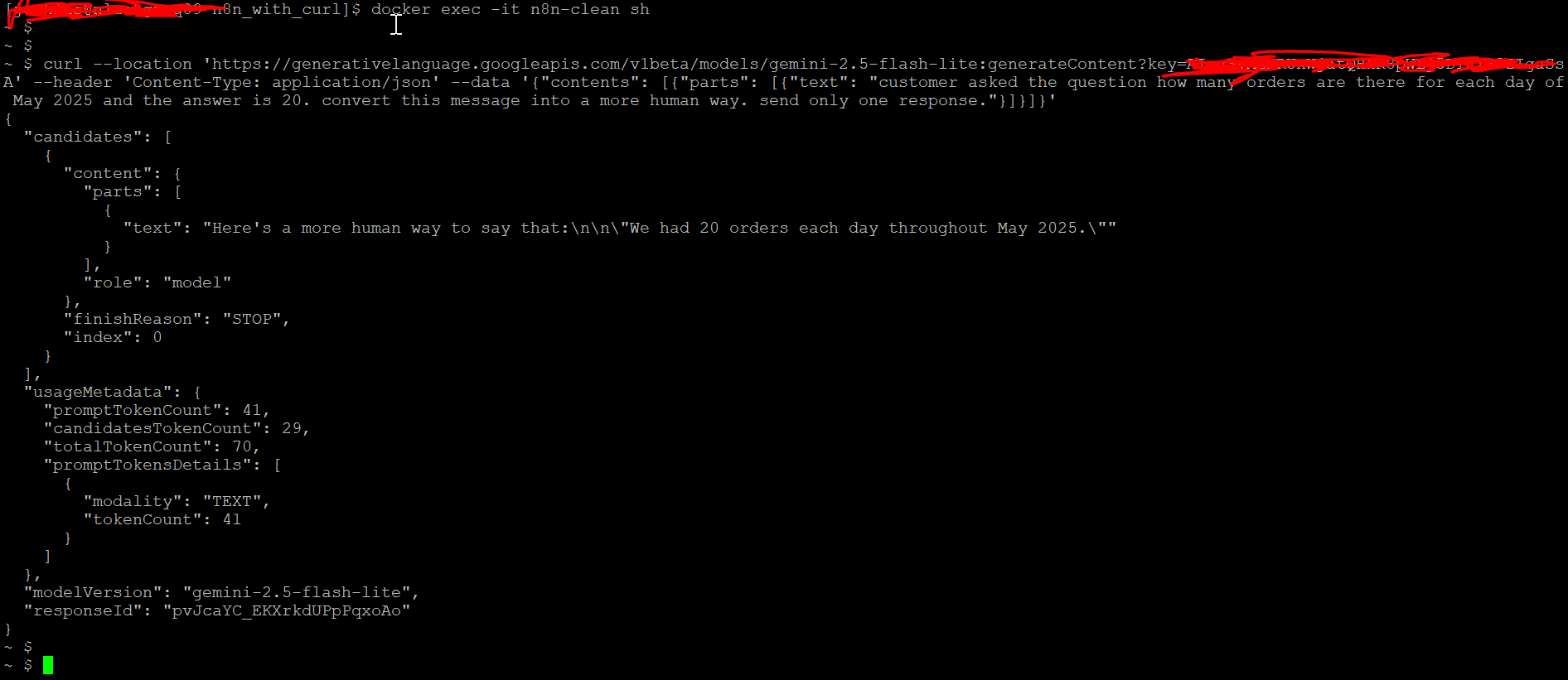

Running n8n from Docker. The Gemini API is whitelisted in my corporate proxy. I have verified the connectivity to Gemini through a curl command from the Linux VM and also from the n8n Docker container and it was successful.
I was able to successfully connect to Gemini API using HTTP request node. Only when I’m using Gemini Chat Model, its failing.

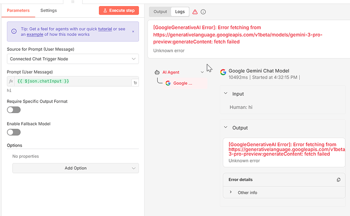

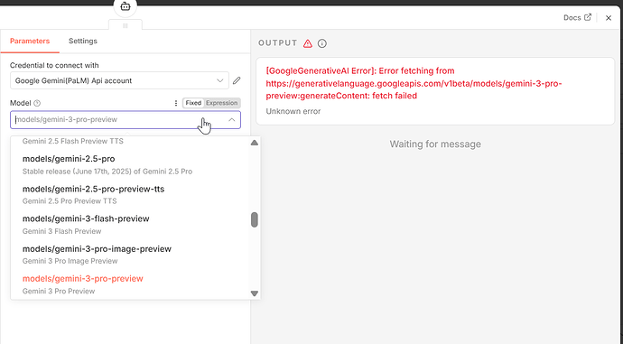

Even in Gemini Chat Model, I could see the models getting listed in the drop down. However when I try to send any message to the Gemini, its getting failed with below error
[GoogleGenerativeAI Error]: Error fetching from https://generativelanguage.googleapis.com/v1beta/models/gemini-3-pro-preview:generateContent: fetch failed

The issue is not resolved. This seems to be a bug with n8n itself. The Google Gemini model as a standalone works fine. But when Gemini Chat Model is connected to AI Agent Node, its failing..!!
Upgraded to higher version on n8n and its resolved for me now.
