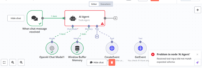

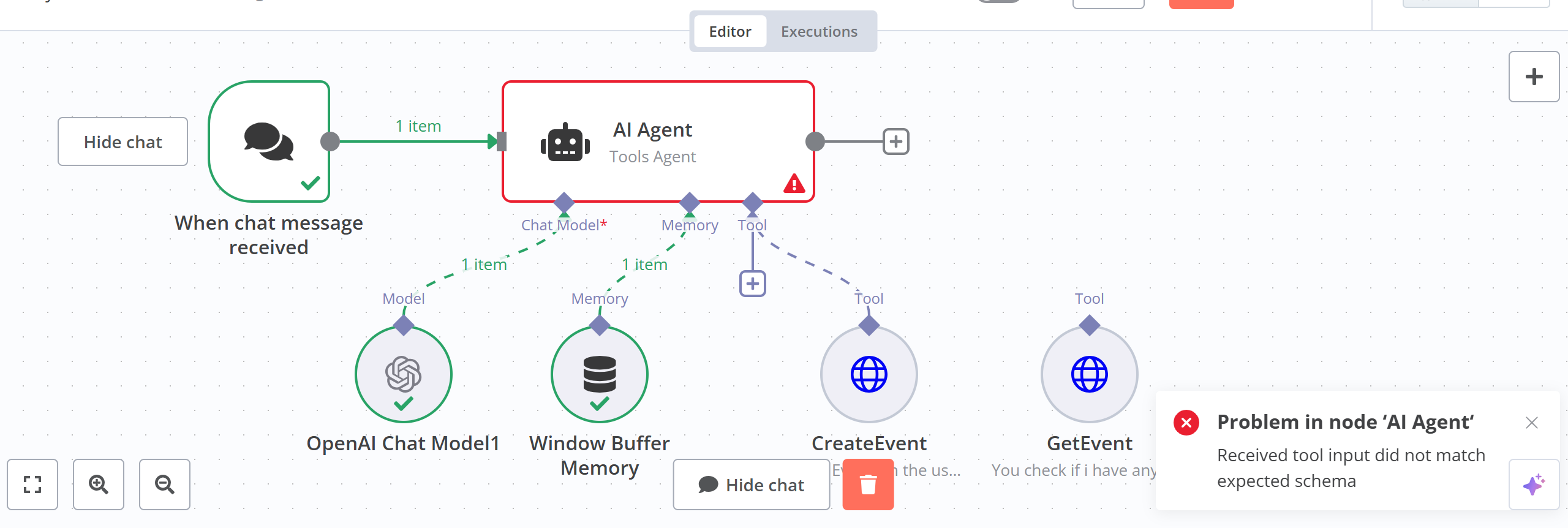

i am new to n8n and I am trying to buld an all arounder agent. For now i want to automate my calendar (outlook). To get more options I am using the http request node accessing Microsoft graph Api. Right now I am stuck at that the agent won’t use my given tool. I would appreciate every help :slight_smile:
I get the following problem if i execute my flow. My Ai agent won’t even call the connected tool allthough it is active.
Probleem is: Problem in Node AI Agent (Received tool input did not match expected schema)

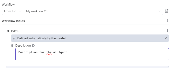

  1. Instead of directly using the “HTTP Request Tool” node, you can implement the “Call n8n Workflow Tool” node to trigger a subworkflow.
  2. In this subworkflow, start with the “When Executed by Another Workflow” node, which allows you to define your desired input schema.
  3. Following this node, you can then place the “HTTP Request” node to perform your API call.
Returning to the primary workflow (the AI Agent), the “Call n8n Workflow Tool” node lets you specify all inputs that the AI should set.
Could you also let me know if you eventually managed to resolve the issue without needing this workaround?
I’ve attached a screenshot illustrating how this workflow setup could look.

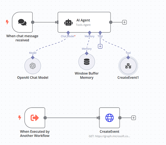

@dataki but aren’t we limited in how many workflows we can get activated?
So the ai started to call this tool. But I couldn’t put any placeholders to let them get defined by the ai. How I am able to tell the ai to put certain fields into it?
BR
Automate.it
Hi @Automate.it,
Could you please share your workflow?
  • With the “When Executed by Another Workflow” trigger, you should be able to configure your Workflow Input Schema.
  • Then, in the “Call n8n Workflow Tool” you can specify how the AI should fill in the input that will be sent to the other workflow.
Tip:
If you’re using the cloud version, yes, there is a limit on the number of active workflows.
But, you can use a single “When Executed by Another Workflow” trigger on the same workflow that contains the AI Agent calling it.
In your case, you can instruct the AI Agent to pass an action parameter (for example) when calling the subworkflow.
This parameter could take values like createEvent or getEvent and within your subworkflow, you can use a “Switch” node to direct the flow along different paths based on the action, each with its appropriate HTTP request.
