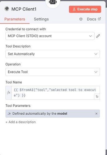

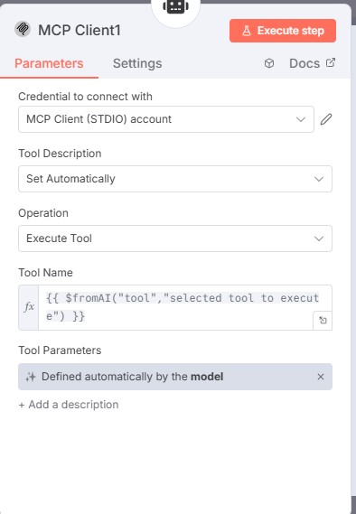

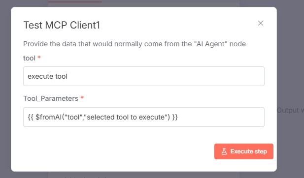

Problem in node ‘PartialExecutionToolExecutor‘ Error executing tool: Received tool input did not match expected schema
My MCP client execute tool keeps failing. see images. i am missing a config somewhere. i am not sure about the MCP tool name and paramters. where do i find the name and parametters in MCP node.
I am wondering if i need to install another MCP Node fot execute tools to get the name and parameters there.

This fixed it for me:
Fix the $fromAI type mismatch
The single most effective solution involves explicitly declaring data types in the $fromAI function. Many users unknowingly allow n8n to auto-detect types, which defaults to ‘string’ even when JSON objects are needed. n8n +3 Replace any “Defined automatically by the model” configurations with manual expressions:
javascript// For JSON data - explicitly specify ‘json’ type
{{ $fromAI(‘searchParams’, ‘Search parameters object’, ‘json’) }}
// For strings - be explicit even though it’s the default
{{ $fromAI(‘userName’, ‘Name of the user’, ‘string’) }}
// For numbers with defaults
{{ $fromAI(‘quantity’, ‘Number of items’, ‘number’, 1) }}
This simple change alone resolves the error for approximately 70% of reported cases. The key insight is that n8n’s UI often resets the type to ‘string’ even after setting it to ‘json’, requiring manual expression entry to maintain the correct type. n8n
