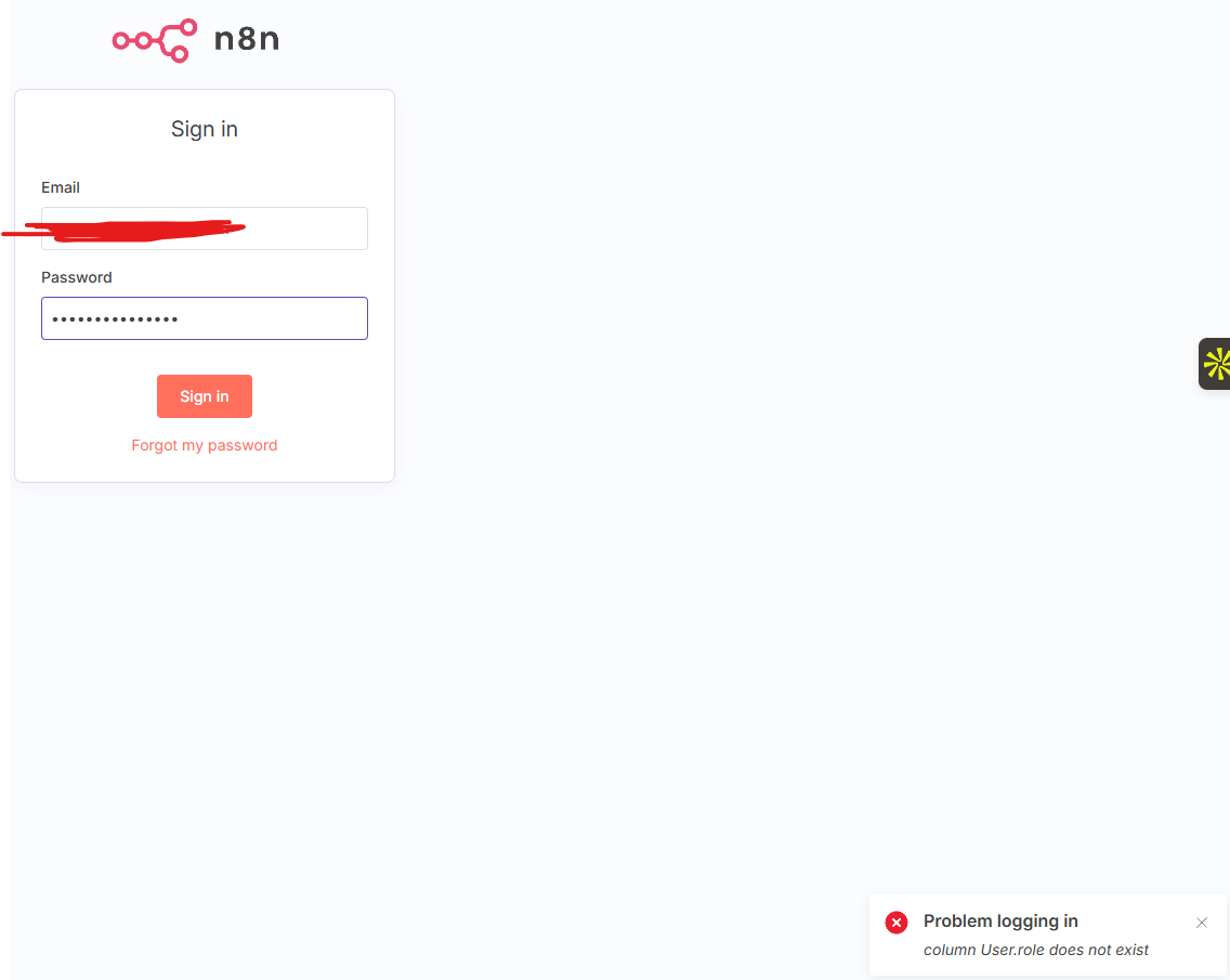

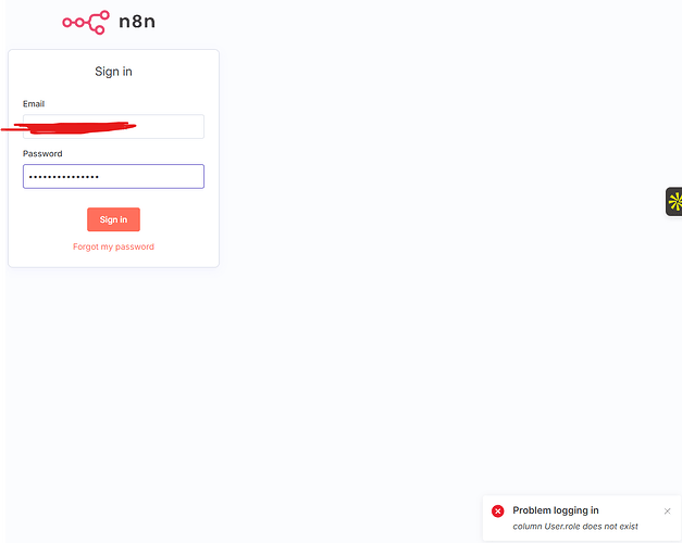

Problem logging in column User.role does not exist
I am not able to log into my deployed version of n8n on RailWay
Problem logging in
It is not a workflow problem, but rather that I am not able to access my n8n instance with all my workflows.
Not a workflow problem

Hi @hinzzx
Have you migrated to a newer version of n8n recently?
I think so, as after I checked the docker image n8n version it said: 1.110.1 (Railway did this themselves)
Thank you for confirming.
This typically means that your n8n database schema is out of sync. Specifically, n8n is expecting a role column in the User or user_entity table that doesn’t exist. That often happens when a database migration fails or doesn’t run properly after an upgrade.
  • This could be resolved by triggering or reapplying migrations.
  • Alternatively, export your workflows, deploy a fresh n8n instance on Railway and re-import to avoid schema issues.
If migrations keep failing, the only way I could think of is to consider rolling back your n8n version and re-upgrading gradually to apply migrations one-by-one.
Hope this answers your question. :slight_smile:
I’m having the same problem… I’m using Docker and updated to lastest today, and I’m having the same issue. How should I restart the migration process? By rebooting the instance? By entering the image and running a command? Thanks for the help.
Ok, solved! I restarted the instance and ran the migration. Everything’s working correctly!

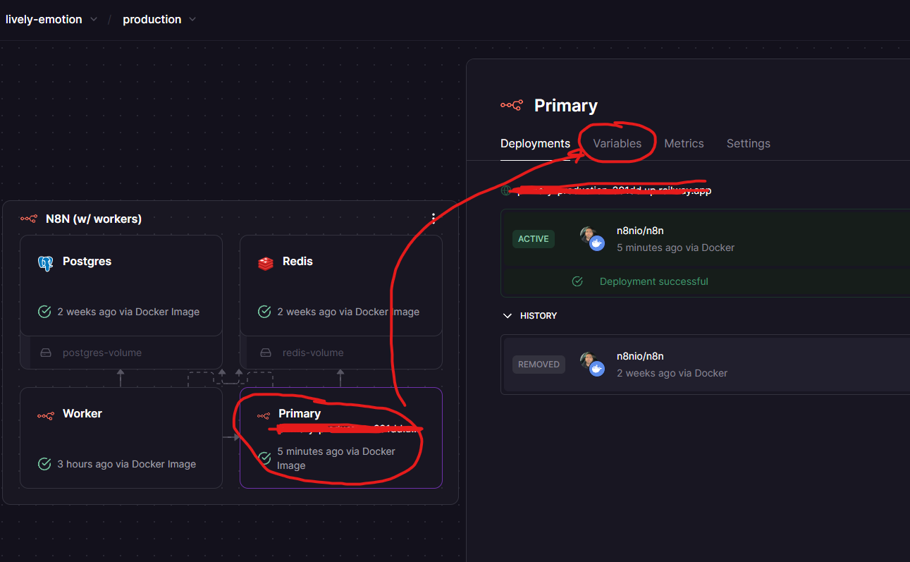

The solution for me in a Railway App was this (thanks to the guys here and a little assitance of ChatGPT):
Go to your deployment instance (in my case it was named “Primary”).
Click on Variables;
Then Add new Variable: N8N_RUN_MIGRATIONS
Set the value to “true“
Deploy
Then you can remove that variable!
Thats what helped for me.

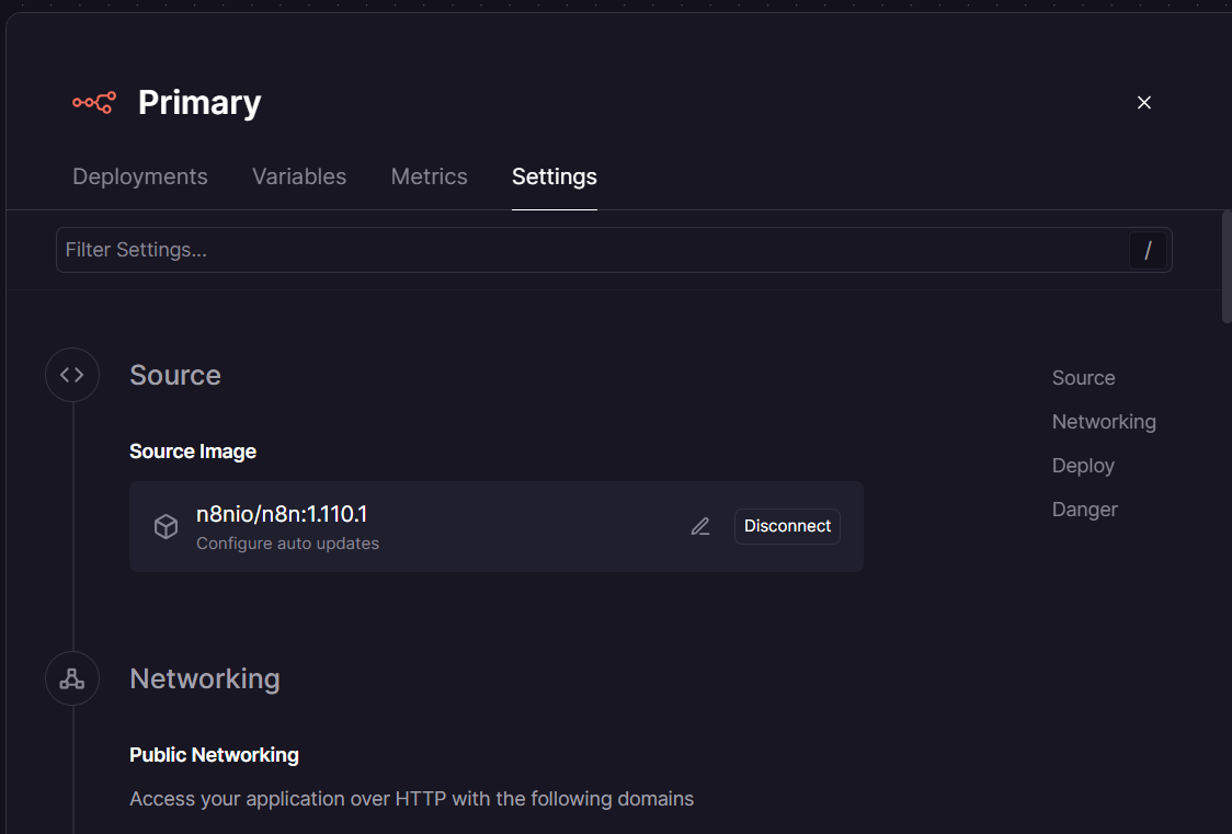

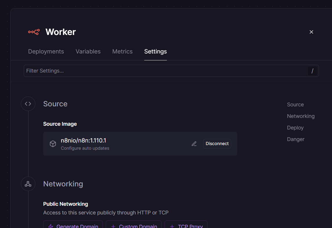

@Recevia_Ai @Admin_Darkfunnels i tried a lot of solutions and i suppose that i found one. From 30 minutes everything works pretty cool and didnt crash.
What i did:
You have these blocks:
Go to primary → Settings and find section “Source image”. You should have n8nio/n8n. Change it on: n8nio/n8n:1.110.1

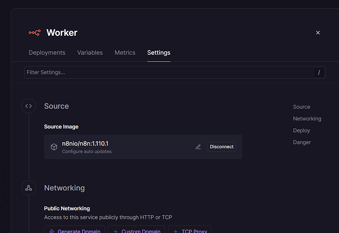

Do the same thing in worker. It should looks like this:
After that click Redeploy. I think (im not 100% sure) it help in my case. Everything still working. If it crash i’ll inform you

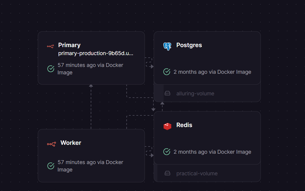

I can confirm redeploying my Worker fixed the issue
Man i love you <3 I was struggling with this 8 hours with gemini. Try out everything. And finally found your commentary. Its worked!!!

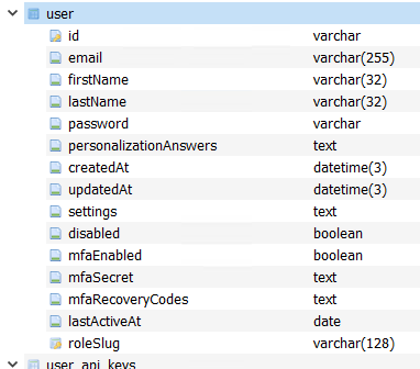

Hi! I have the exact problem here. How to solve it with NPM? I checked the user table in the database, and yes, there is no user.role column.
I have tried to downgrade my n8n version to 1.101.1, this is (I guess) the last version that is working fine before I upgraded to the latest version which is not working
I solved it! Just alter the column name, from roleSlug to role
