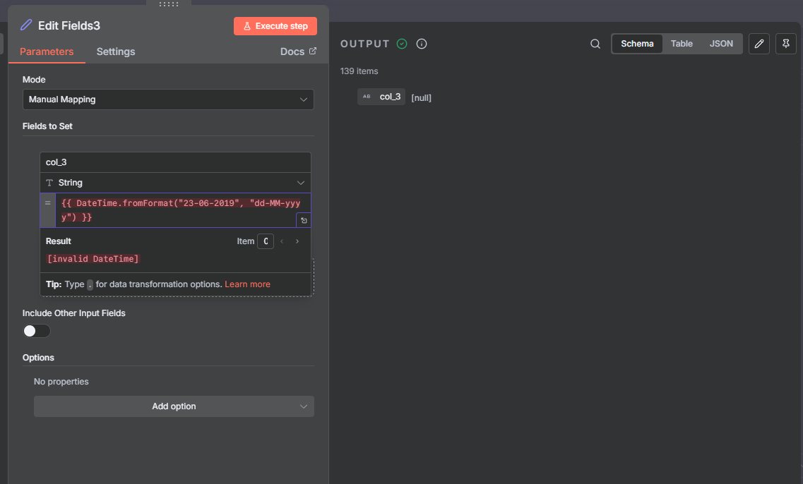

Hello, I’m experiencing an issue when attempting to evaluate a date in my flow. I’m testing with the example provided in the documentation, but even that is causing problems.
Anybody knows how to solve it?

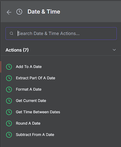

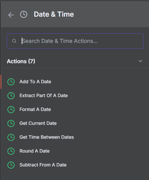

Use the built-in Date & Time node instead of parsing dates manually.

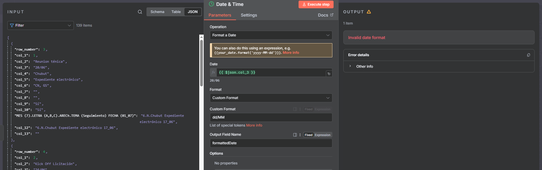

I also tried different ways but always gives me error:
I even used a JavaScript function to convert it to the date format dd/mm/yyyy and ISO date format, but once I successfully converted it, neither the Date Time node nor the If node recognized it as such.
My solution was to use a Code node and manually filter with conditions, but not with nodes. If you know any way to do it without code, that would be perfect.

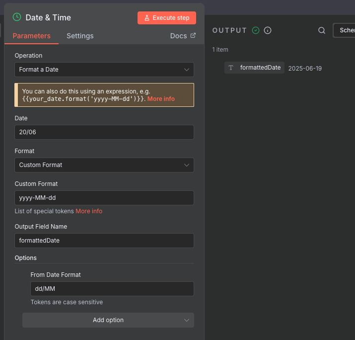

The problem in your Date & Time node is: You are trying to convert a date into an invalid format(dd/MM is not a recognized output type). However, I noticed that you haven’t added From Date Format option in your node. Could the issue be that you mixed up these fields?
→ From Date Format : Input date, added from Options, in your case its dd/MM.
→ Format : Desired format to convert into(e.g. yyyy-MM-dd).
