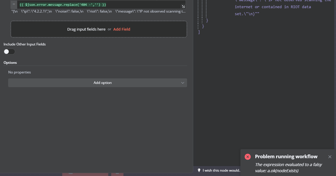

Problem Running Workflow: The expression evaluated to a falsy value: a.ok(to)
I have created a workflow, and it worked fine. But one time I ran the workflow and it returned this error: Problem Running Workflow: The expression evaluated to a falsy value: a.ok(to). After that, I cannot run any node in the workflow and they always returned the same error. When I refresh the page and ran the workflow again, it worked. But when I run the workflow the second time, it still returned that error

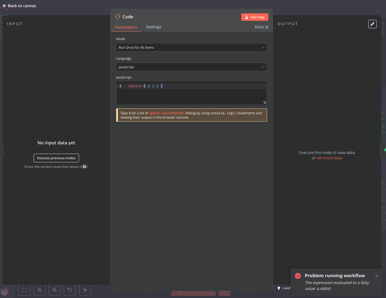

Same problem here.
What I noticed is that the error happens on the second attempt.
Even this silly code like return { a : 1} it fails.
So, it seems that is not related to my particular code or workflow, but maybe a N8N bug.
