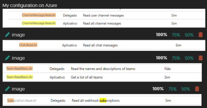

I’ve already reviewed the settings, but not all of them are in Azure.
The permission Subscription.ReadWrite.All is not available in our tenant, we only have Subscription.Read.All.

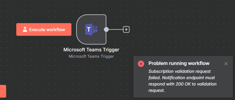

I can send and receive messages from Teams manually but not on the trigger node
Subscription validation request failed. Notification endpoint must respond with 200 OK to validation request.

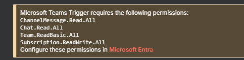

Required permissions n8n
My configuration on Azure

Hey @Fernando_F_da_Silva ,
Are you the tenant admin ? You need to be global admin to grant this role
Hello, I did it together with the tenant admin and even with the admin user this option does not appear
I am tenant admin in my companies tenant and I can confirm, that the Subscription.ReadWrite.All permission does not exist for us in the Graph API permissions section.
Subscriptions.Read.All does exist under delegate permissions.
Thanks @SMS-T1, but if that permission doesn’t exist, what’s the problem? Are there any other permissions missing?
Actually, I’m not sure if the problem is with Azure or n8n.

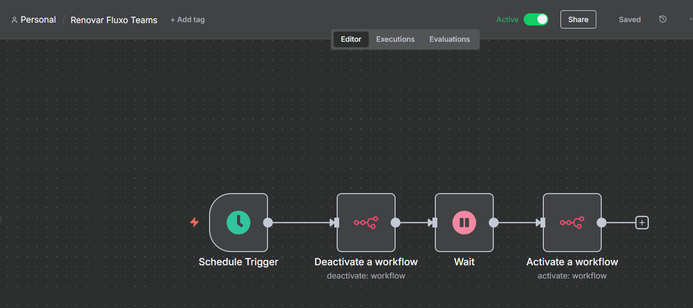

I’m facing the exact same issue as you. I tried creating a flow that disables and re-enables the workflow periodically — just to check if it could help with some kind of Graph API re-indexing or webhook refresh behind the scenes.
Unfortunately, that didn’t solve it either. The trigger still works only occasionally and then stops listening to new messages, even though permissions and everything else seem to be correctly set.
