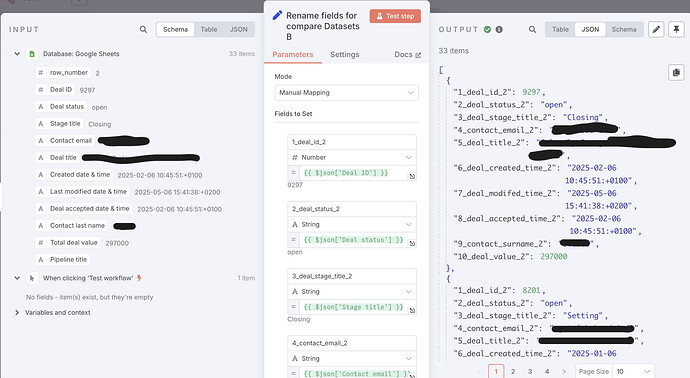

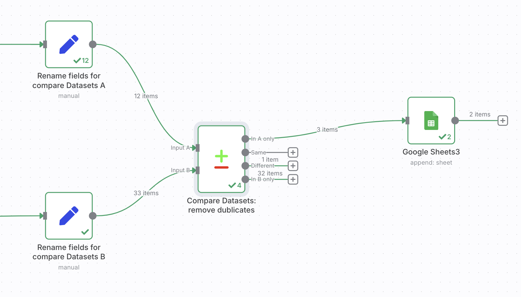

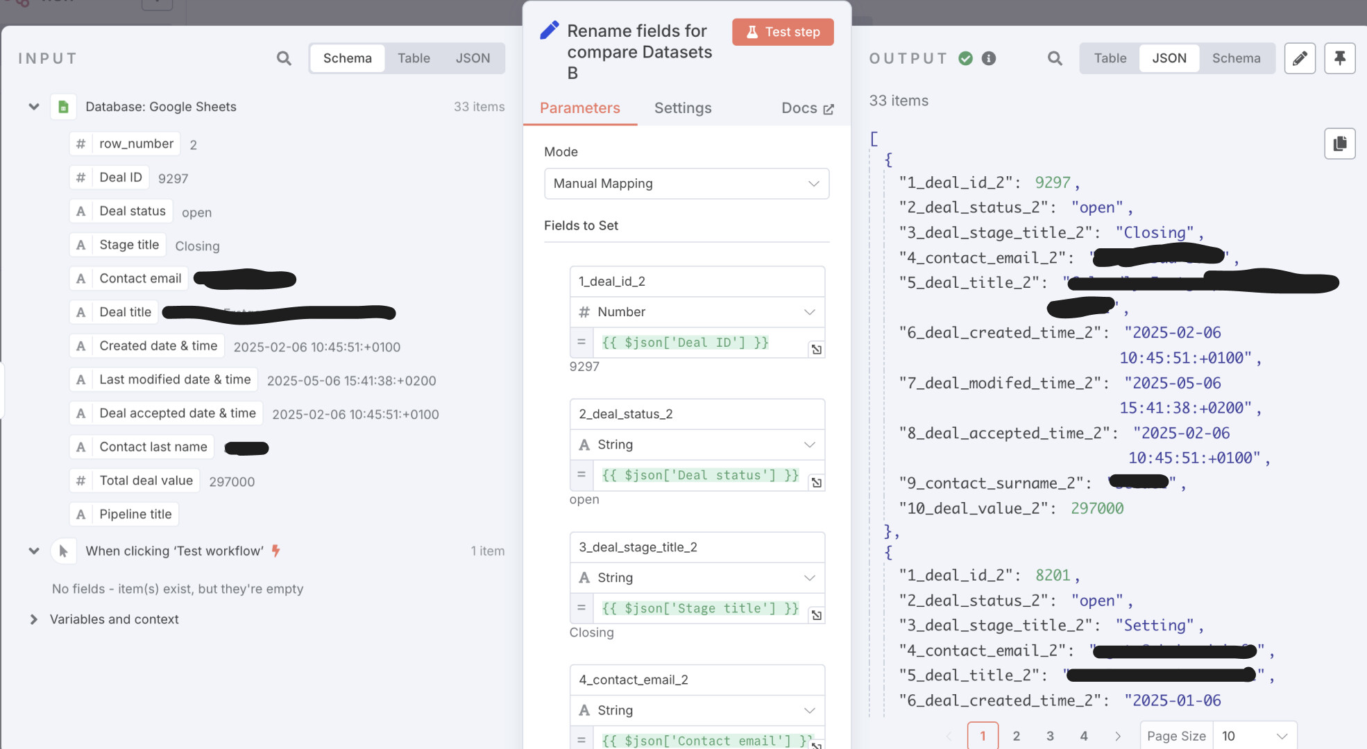

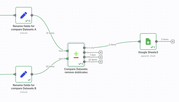

I am building my workflow where I use the Compare Datasets Node.
The main issue is that this node does not show information from input B. It says: “No fields - item(s) exist, but they’re empty.” Sometimes, it shows the same issue for input A as well. It seems that the Compare Datasets Node can only receive one input.
Could you let me know if this is a bug on the n8n side or if I am doing something wrong?
Input A: Information comes from an HTTP request.
Input B: Information comes from Google Sheets.

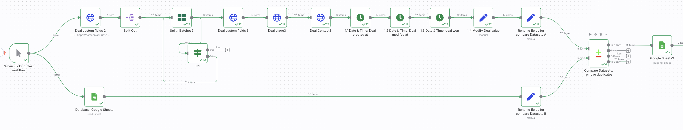

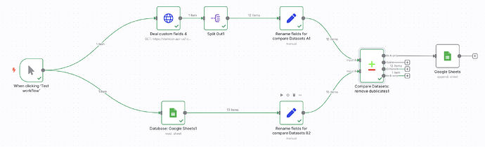

and I think maybe it’s lost the data as the last node is datasetA, and dataset B is on another flow, but I would like to try further locally if okay, see if I get the same results
I would need to change https requests information, because they contain user data. I will try to prapare a demo workflow with a test data.
It does not look that data is being lost on its way. I have a feeling that this is a bug. Or it is about timing, because A Input receives data earlier than B Input.
Applogies, I meant delay, into the workflow, also it might work, you could place everything in the same row, and then reference that nodes output into the comparedataset node? maybe its losing the data from seperate flows?
