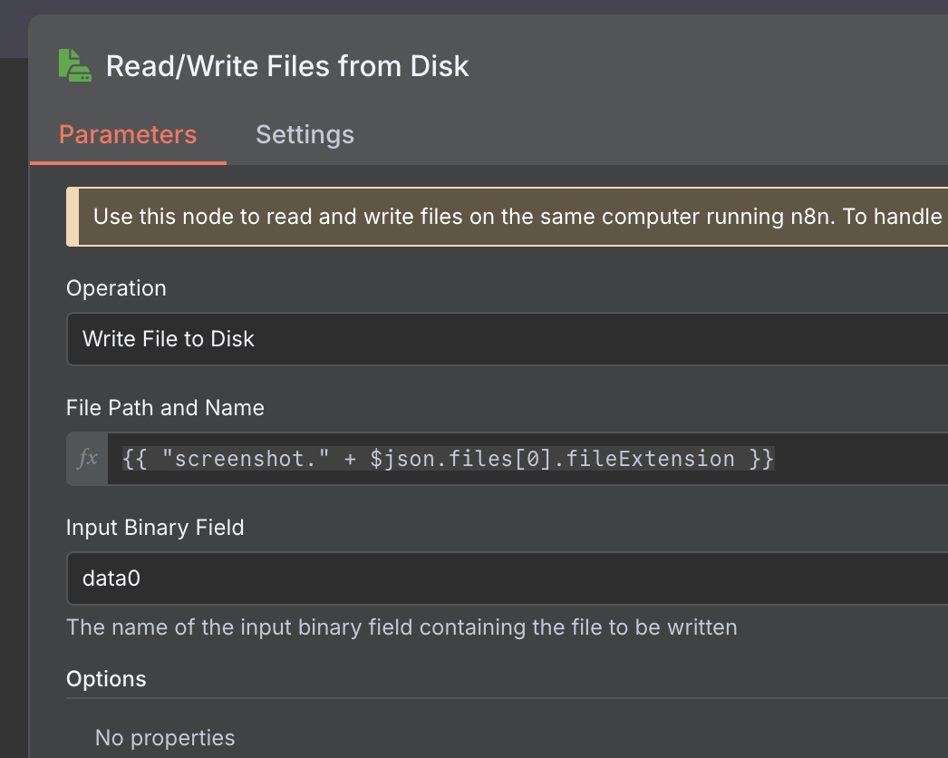

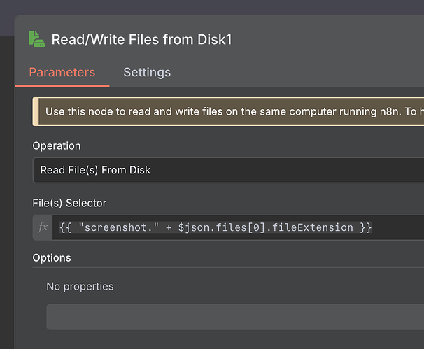

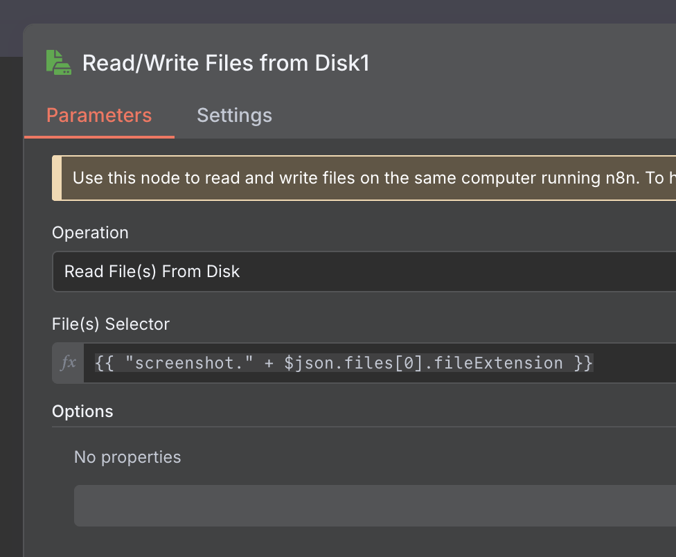

Hey, unfortunately n8n doesn’t handle binary data that well yet. I solved a similar issue recently by saving the binary data to disk using Read/Write files from disk node, and then later reading it with the same node. Maybe this approach works for your workflow too?

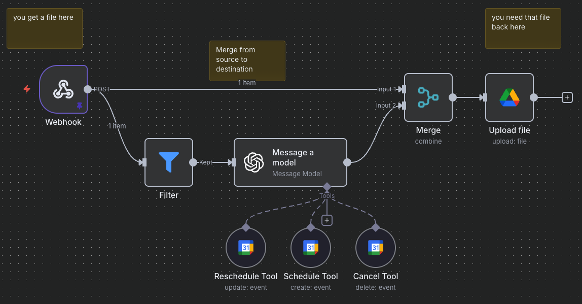

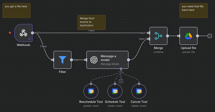

An alternative to saving and then re-reading the file back described above is merging your node at the beginning with the one where you need the binary. Merge node will allow you to bring the binary to the place where you need it. It looks sort of ugly, but it works.
Here is a quick example:
